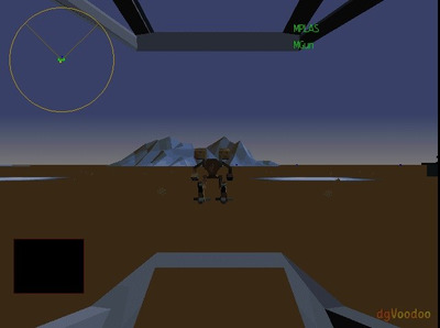

Reply 385 of 392, by schlang
Thank you for creating this awesome installer.
I'm not sure if I follow all the posts correctly, is it possible to play the original 3Dfx version with dgVodoo2?
I can get the game to run but from what it looks like it only runs in the normal software mode through dxwind/dgvoodoo2 hooks?

Reply 386 of 392, by myne
The HUD is 640. All attempts to change that ended in glitches so I didn't bother trying.
The rest is whatever you set it to. Look close and you'll see its not 640
