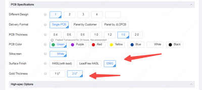

Reply 125 of 144, by zuldan
I just ordered 5x PCB's from JCLPCB. This is how you change the Gold Thickness to 2U
42.63 KiB
1130 views
What's the best way to test for shorts on the chip once I've built it? I'd hate to install it in my M919 and then hear it go POP!

Reply 126 of 144, by feipoa
zuldan wrote on 2024-08-28, 03:17:
42.63 KiB
1130 views
That's also what I did.
What's the best way to test for shorts on the chip once I've built it? I'd had to install it in my M919 and then hear it go POP!
Probably check resistance from: Vcc to GND
Maybe check each memory chip: Vcc to an the adjacent pin .
If you want to be really meticulous, check every memory IC pins for adjacent shorts. Also check each IC pin for contact to the pad. If using solder paste, having non-contact between the pin and the pad is a common occurrence I've run into with SOJ and QFP chips, and usually with older solder paste.
Common problems are non-contact with the memory IC to the solder pad and shorts between adjacent memory IC pins. Perhaps the next most common issue is soldering capacitors too off centre, which may result in shorting Vcc to GND.

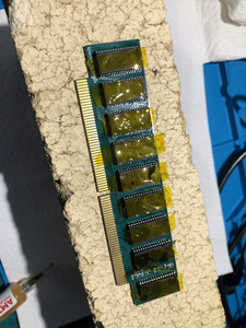

Reply 133 of 144, by zuldan
After spending well over $150 for the PCB and parts and after 4 hours I soldered a stick together. Double checked for shorts and checked solder joints. The machine powered on, no magic smoke 😀 The machine booted fine. I then went to the BIOS and enabled the 2nd level cache. The machine booted, did the memory count then just sits at “Wait….”. Tried 6 different FPM memory sticks. No luck.
These are the parts I used
https://au.mouser.com/ProductDetail/727-CY1019DV33-10VXI
https://au.mouser.com/ProductDetail/667-EXB-V8V330JV
https://au.mouser.com/ProductDetail/80-C0603C104K9R
I must have done something wrong but I got no idea how to diagnose what is wrong. There is no way I’m going to spend another 4 hours soldering another one 😉
Any suggestions would be greatly appreciated.

Reply 135 of 144, by rasz_pl
zuldan wrote on 2024-09-29, 10:33:
This hints at problem with solder work 🙁 Its just 9 TSOPs, very easy to drag solder, even easier with hotair. 20-30 minutes tops.
Take some macro pictures in good light, maybe you will spot problem in the process.
Look for a hackerspace/makerspace/ham club near you and get a second opinion.
https://github.com/raszpl/FIC-486-GAC-2-Cache-Module for AT&T Globalyst
https://github.com/raszpl/386RC-16 memory board
https://github.com/raszpl/Zenith_ZBIOS MFM-300 Monitor

Reply 137 of 144, by zuldan
rasz_pl wrote on 2024-09-29, 19:03:
I used a heat gun plus flux and reflowed all the solder joints. Unfortunately it made no difference.
692.27 KiB
721 views
I think I’m going to try different memory chips. Will try these next https://au.mouser.com/ProductDetail/Renesas-E … %252Bu1Lg%3D%3D
I’m also going to use a heat plate at 260c and solder paste to reduce the time it takes to solder every single leg of the memory chips. Wish me luck. May the force be with me 😉
