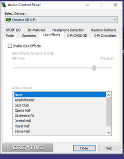

Reply 464 of 484, by KainXVIII
UCyborg wrote on 2025-06-08, 19:23:
I see, does this dialog update in real time when you're playing EAX enabled title, seeing it has Active Preset box? Or maybe that applies if you've set global EAX effect in another place?
Active presets only work in Entertainment mode as far as i know
20.13 KiB
550 views
PS - also, during win9x era i remember that Creative had custom presets for some games that don't support EAX presets natively (for something like Fallout, Die by the Sword if i'm not mistaken), i wonder where i can find them now and if they still work in win10..
Reply 465 of 484, by UCyborg
I wouldn't know about those presets...did Sound Blaster PCI 128 have them? At least that's probably the most interesting card that some of today's PC emulators can emulate.
BTW, @KainXVIII and others, can you check what EXE file opens that Audio Control Panel on the screenshot in the post above?

Reply 466 of 484, by sharangad
UCyborg wrote on 2025-06-09, 09:32:
Creative audio console

Reply 469 of 484, by KainXVIII
I don't remember, need to google this further..
Audio Control Panel = CTAudCS.exe
Reply 470 of 484, by Joseph_Joestar
IIRC, the only time I saw those special presets for non-EAX games was when using a SBLive with the stock drivers from its installation disc.
I don't use SBLive cards in my retro rigs anymore, so I can't say for sure.

Reply 474 of 484, by KainXVIII
Joseph_Joestar wrote on 2025-06-09, 20:10:
Yeah, that's must be it! Probably just a simply reverb preset for every game.
Reply 475 of 484, by MadMac_5
KainXVIII wrote on 2025-06-10, 09:06:
The Live did indeed have presets for different non-EAX games, and you're right; they simply applied an "appropriate" amount of reverb and chorus effects to every sound played in the game. I remember trying it with Descent: Freespace after I got my Live in the summer of 1999, and I did not like how it sounded. After downloading Volition's actual EAX patch the reverb was still a bit gimmicky, but the 4-speaker positional sound worked at the very least.
