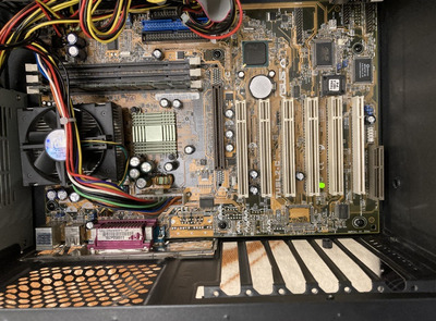

Hello good people at Vogons.
I have been reading through your website for many years now, and now it's the first time I'm compelled to write)
If someone owns (or owned) the above card (Sapphire HD 2600 Pro AGP) , your input is very much welcome here.
I have a TUSL-2C motherboard with a "universal" AGP slot, which theretroweb.com says is 3.3V.
By some crazy bout of greed I've snatched a 8x Sapphire 2600 Pro AGP from the flea website.
The logic was, that 8x should be backwards compatible to 4x "universal".
NOW I'm having many second thoughts. If my TUSL 2C is actually 3.3V ONLY, then the Sapphire will burn?
But from this excellent guide https://www.playtool.com/pages/agpcompat/agp.html I have figured out, that since the TUSL-2C is an Intel 815 chipset, the AGP is actually "universal", which provides both 1.5V and 3.3V (contrary to what theretroweb.com says).

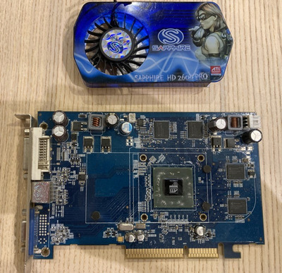

The box art of the Sapphire says it is not pure 0.8V, but can work as 1.5V (as playtool.com points out, the pure 0.8V cards are super rare at best, if any do exist).
So now there is a Sapphire neatly clean with a new thermal pad and an extra copper radiator for the 218BAPAGA12FG PCI-E to AGP chip on the backside.
And the lurking realization it probably should not have been bought in the first place, as it's not supposed to run at 4X"universal" TUSL-2C, which is 2X-4X universal 3.3V, but not 4X-8X universal 1.5V.
I hope I'm not breaking any rules here, and thank you good people for all comments you could have in regards to this crazy business here...
Unfortunately both them Sapphire and TUSL manuals are pretty vague about this topic.

Reply 2 of 17, by Halofiber86
Matth79 wrote on 2025-06-10, 12:33:
From the IO/AGP voltage selection, it does seem that it could predate the standardisation of AGP 2.0 and 4x/1.5V
Thank you for your reply. I greatly suspect that you are right. Now I have even more doubts. Maybe I should just put this Sapphire in the glass box and stick with my current FX5200.
Reply 3 of 17, by tehsiggi
Is there anything particular about the HD2600 that you wanted? Or just a "good quick buy"?
From my (year long painful) experience, I'd avoid any Rialto bridge powered card for a good experience. They can be very tricky to get happy with 🙁

Reply 6 of 17, by tehsiggi
That "cloth" is basically a thick thermal pad. They used it for protection of the exposed die. They usually had no cooling attached to it. With a relatively decent airflow, it's good enough.
If you search for pictures of other rialto based cards, like x700 AGP, X1950 AGP or HD3850 AGP you will see they never came with a cooler on rialto out of the box. (afaik)

Reply 7 of 17, by Halofiber86
tehsiggi wrote on 2025-06-10, 14:07:
Done that and see that indeed Rialto is typically not cooled, just padded around with this pink padding. We have to consider that these things were never meant to last 15-20 years though. Before this TUSL-2C I have had a Lucky Star 440BX motherboard that broke this winter. I tend to blame the 443BX chip - which had no heatsink and did okay for many years, but in the long run I suspect this turned out to be the weak spot.
Here is the video with the Rialto heatsink that I have found: https://www.youtube.com/watch?v=i1cU3xorwhI
The guy flips the card over at 0:10 to reveal a pretty massive heatsink.
Reply 8 of 17, by Archer57
Halofiber86 wrote on 2025-06-10, 21:30:
That's a good solution, even though it is not really "massive" - you have to remember that all this chips sink heat into PCB pretty effectively, which in large part is copper. Many SMD components are built/rated with this in mind. So that aluminum (presumably) plate is not really much better in terms of surface area than the PCB itself, and since it covers the PCB...
The issue i have with just gluing something to this chip is - it is a chip with bare die + some tiny SMD components on substrate, which are protected by those pad. Simply removing those pad and gluing something on top of bare die feels wrong. It will create mechanical load on the die and whatever compound is used to glue it to substrate which is not a good thing. Especially with how small the die is - the heatsink will either have to be inconsequentially small or you'll risk mechanically breaking the chip.
To properly cool it there has to be a way to mount the heatsink to the PCB itself, as it is done with, for example, chipsets which have bare die. And on this cards no such way exists.
As much as i'd like to attach a heatsink to the chip i can not think of a good way to do it and just gluing to bare die feels wrong and worse (more likely to damage the chip) than no cooling at all.
Also that guy poking at GPU with a screwdriver, then proceeding to scratch up copper heatsink with the same screwdriver and then use sandpaper on it... that's why i prefer to buy things nobody "serviced" before. That's just painful to watch. Use some alcohol and some cloth or paper to remove old thermal compound, no need to damage things.
