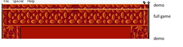

I have noticed that cause of some reason Prince of Persia 2 demo has got two right most vertical lines removed making intro doesn't look nice. That was somewhat changed in full version where it is removing two vertical lines from the middle of the screen (line 17 and 18 from the right) so that it is less visible.
Nevertheless cause of some reason both versions have horizontal resolution lowered from 512 to 510 lines.
