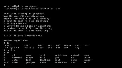

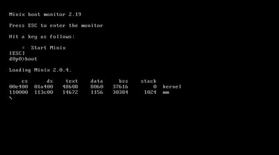

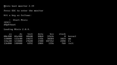

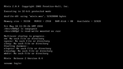

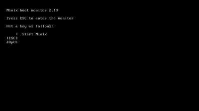

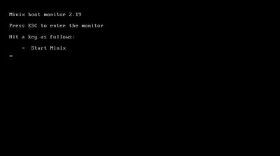

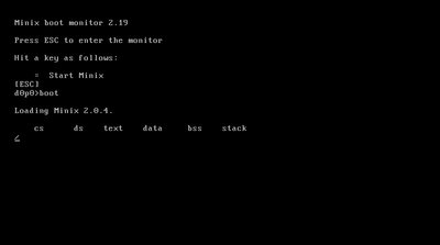

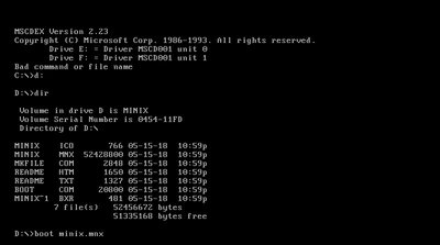

Reply 2 of 15, by superfury
Running the MS-DOS boot.com on the minix.mnx image results(tutorial from https://virtuallyfun.com/wordpress/2009/10/09 … dos-minix-2-04/) in the following(running from MS-DOS 5.0 in UniPCemu instead of Dosbox):
1. I'm greeted with a message telling me to choose something. I press enter.
2. It starts the kernel, then proceeds to mount four partitions?
3. It then reboots(triple fault?) after seeing a flash on the screen about some little text with a turning thing again(on the third row I believe):
First steps of the booting process:

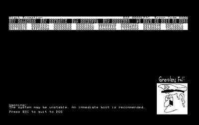

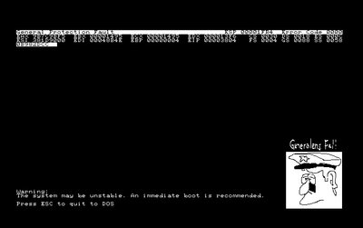

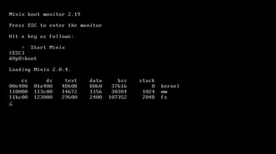

Reply 3 of 15, by superfury
And the final steps before crashing(triple fault it seems):

Reply 4 of 15, by superfury
Looking at the CPU state itself, it seems to triple fault. The previous instruction was running at CS base address E400. So it's somewhere in the kernel?
The base of CS is still E400, with a 4GB limit. All other segments have a base of 1A400 with a limit of 4GB. CPL is zero, so it's still in the kernel.
It seems to have encountered an #UD exception(for executing a FFFFh instruction), at logical address 05c70009h(the value of EIP when the instruction starts)? Paging is disabled(so it's trying to execute non-existant physical memory). Anyone knows anything about this? Previous opcode was C3h(A RET instruction).
Edit: OK, it's already running in protected mode during the loading stage. So somewhere after that, after loading init, it ends up at an unknown 0xFFFF opcode?
Edit: Here's a common emulator log of the kernel loading (starting somewhere within the kernel image loading) and crashing(look for #UD in the log):

Yay! More progress:
68.33 KiB
2046 views
Minix reaching the login prompt. Some commands cannot be found?
Although some command cannot be found within it's filesystem?
Edit: Yay! A prompt from Minix is now showing up(after entering root as username and waiting for a while!) 😁
Edit: Prompt seems to be slow, but working! 😁
71.67 KiB
2045 views
Minix is running!
Edit: Compiling itself seems to fail due to not being able to write to the /tmp directory or a subdirectory within it(some compiler code about write error writing some temporary file).
"part" seems to run fine.
Running "shutdown" properly returns to the loader. Then running set gives the correct information. Finally running exit returns to the MS-DOS prompt:D And of course the MS-DOS prompt is running fine.
UniPCemu Git repository

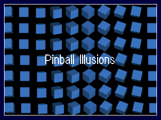

Reply 10 of 15, by hottobar
You could also try to run some demanding protected mode DOS game, like Pinball Illusions.
Look at what that game throws at me when I try to run it with my emu: https://github.com/barotto/IBMulator/issues/32
Reply 11 of 15, by superfury
Just tried Pinball Illusions on UniPCemu. It gives a stack fault(stack exception in the description) instead:
53.43 KiB
1929 views
Stack exception occurring in UniPCemu
This is on my Compaq Deskpro 386 emulation(80386 processor).
Simplified common emulator log:
debugger_pinballillusions_stackfault_UniPCemu20180518_1927.zip
181.28 KiB
74 downloads
Debugger log without registers and memory transactions.
It even looks like it's throwing multiple stack faults after each other(fault handling throwing stack fault?)
Edit: Looking further up the log, there's a #GP fault(#GP(0)) which eventually throws a stack fault. Said #GP fault is a address-size overridden XLAT using the CS segment(instruction bytes 2E 67 D7)?
So it's executing a XLAT CS:[EBX+AL], where EBX=0x2AC7, AL=0x69. So it's reading a byte at CS:2B30?
Looking at the interrupt cause(internal emulator flag for verifying the kind of fault that's the cause of the exception when accessing memory parameters), it says the cause is cause 3, which is a system segment access rights breach(Code, execute-only(w/(w/o)conforming) being read by the instruction as data. CS has access rights 0x9B, which means code, nonconforming, executable and readable, not accessed and valid.
So there's definitely a problem with my emulator's protection handling there. It shouldn't do that on reads, since it's executable and readable?
Edit: It seems the protection module itself works fine. It's the XLAT instructions(both 16-bit and 32-bit versions) that were faulty: it was checking memory against a write(for the memory operand) instead of a proper read.
Edit: Now I see it continuing until loading offset 0x48B4E(Which according to the screen is the value of EDI)? I see it's faulting on a MOV instruction. Odd...
40.28 KiB
1924 views
GP fault on Pinball Illusions
Edit: It seems to be using FS:EDI to address the MOV to write. It's an 8-bit MOV. The instruction that's decoded is 0x64 67 88 07. According to onlinedisassembler.com, it's an MOV BYTE PTR FS:[EDI],AL instruction. The cause of the fault is a limit violation(cause #6). The FS descriptor contains 0004933b74a08b4b(little endian format of the 64-bit descriptor that's loaded). So the limit is 0x48B4B. The EDI registers contains 0x48b4e, so a clear limit violation. Now the question: why is EDI 3 higher than the limit? Some substraction going wrong? Or too much added somewhere?
40.28 KiB
1924 views
New GP fault on Pinball Illusions. This time because of actual limit violation.
