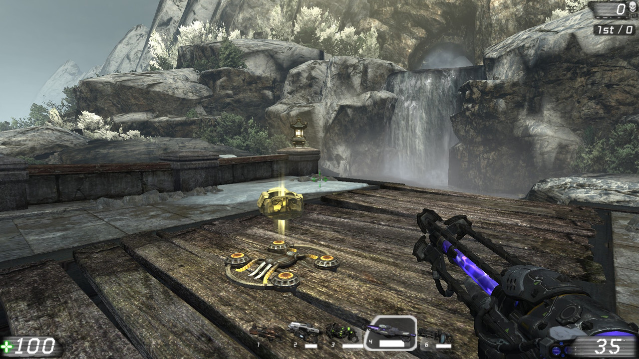

Reply 818 of 1111, by lowenz
UT3 is working but the road to the correct rendering is long 😁
1) snow texture (shader?) not showing (see the mountain rocks)
2) some textures are highlighted (see the belt)
3) some textures (shaders?) are missing (see the shock rifle bar)
dgVoodoo
MS
