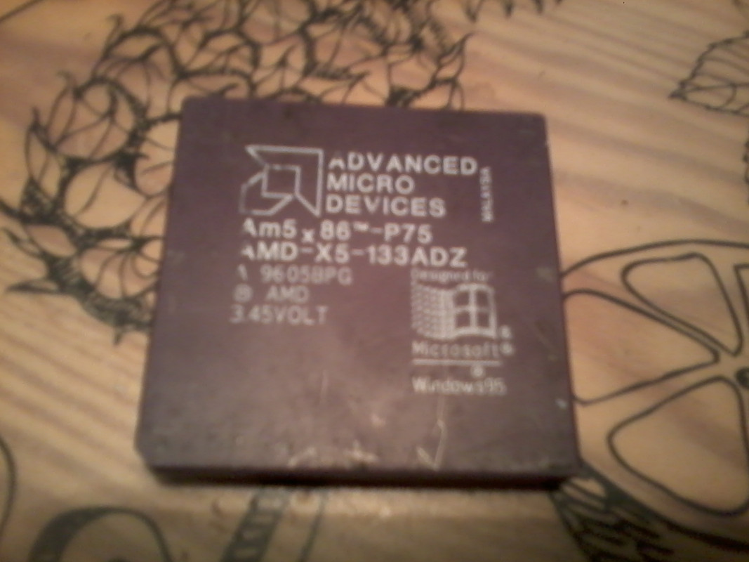

CPU:
AMD 5x86 clocked at 160 Mhz (4x40). I am using a fan and a radiator to cool it a bit.

Reply 3 of 8, by Intel486dx33
That's a good CPU (AZD) edition.
Did you try to overclock to 200mhz ?
Yeah, I have tried setting the bus to 50mhz. Usually the PC does not even post, sometimes it detects CPU as 200 mhz and hangs soon after booting. I don' t see much sense in overclocking to 200mhz and setting wait states, perhaps there would be no speed difference.

did you try more voltage at 200mhz? I don't think stock 3.3V will be any good usually people do 4v and from reading about 586 apparently 4.6V is the tolerance threshold for a amd 586
I never wanted to push past 160 for cpu safety, I got a board with a crystal that can be changed, if there is a 45 mhz crystal I would try 180mhz at 4V... maybye I will look into this
Reply 7 of 8, by Ltsyrek
Well, same here - 5x86 is relatively uncommon where I live, so I prefer to not strain it too much. I am running 5x86 at stock 3.45V and never tried to increase voltage, honestly.
