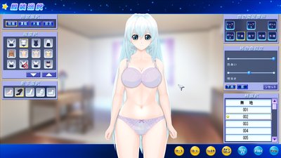

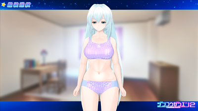

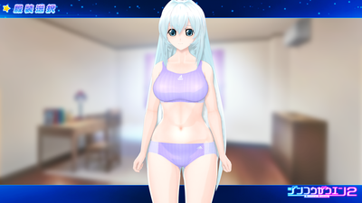

Reply 1093 of 1111, by Arkblade
another test results for AA2 special build.
one machine, with 4K, it have many crashes.
(parhaps video memory? we need to 4096MB option?)
and my experience
in hue/brightness slider on cloth settings,
It seems to cause texture distortion. it will happen underware with user textures.
422.15 KiB
35862 views
normal:
1.52 MiB
35864 views
error:
1.54 MiB
35864 views
