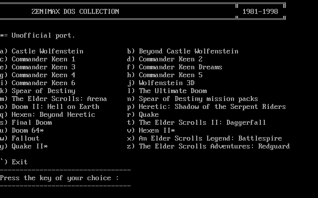

I'm moving this post here from the DOS forums, since I'm using DOSBox (Mac OS X, to be exact). I'm working on a DOSBox wrapper that can run every DOS installment of ZeniMax's major franchises: Wolfenstein, Commander Keen, Doom, The Elder Scrolls, Heretic/Hexen, Quake, and Fallout. Not only am I using official DOS installments, but also unofficial DOS ports created by third parties, such as Q2DOS, Hammer of Thyrion, and Doom 64 in Doom 2. I've linked these games together with batch files, even configuring said batch files to eject/mount drive D with the appropriate bin/cue files when needed. Here is a screenshot of the main batch menu which links these games together, so that you can see all the games in this wrapper.
D_aKTRjXkAEjhKX?format=png&name=small
So far, all of these games work very well in this wrapper. Even Q2DOS, which was once the most unstable game of the bunch and prone to crashing every other minute in its own DOSBox wrapper, is running smoothly and without any crashes or other technical problems whatsoever.
However, I'm having problems getting Battlespire to run at the right resolution. I'm using 1024x640 for the wrapper, so that most of the games will fill up the entire screen on my Macbook. However, it causes Battlespire's screen to be tiny and have thick black bars on all sides. I don't know why it's like that, since Fallout has the same resolution as Battlespire, but is the right size in the wrapper and only has vertical black bars on the left and right. I would just like to know how I can make it so that Battlespire is at a resolution of 320x240 when I play it in the wrapper, yet keep every other game in that same wrapper at 1024x640 when I play them.
DOSBox.conf is in the directory Resources, and is configured to run gamepack.bat, which is the main batch file linking the games together in Resources/Gamepack. The Battlespire directory is Resources/Gamepack/Batspire, and gamepack.bat is configured to run spire.bat in the latter directory. With this in mind, is there anything I could try doing?
Reply 12 of 27, by gdjacobs
I suspect this is vid mode related. Most laptops only support a limited set of output resolutions which results in even less compatibility than desktop LCD displays. You can use scalers to filter the output from DOSBox so it's compatible with your laptop's native display mode.
https://www.dosbox.com/wiki/Scaler
If you want to completely avoid interpolation, use a DOSBox build that incorporates the pixel perfect patch such as YP80's ECE build. Note, however, that the DOSBox devs may not be able to assist with any issues that crop up with third party builds, as they won't necessarily be familiar or agree with changes introduced in out of tree patches. Always go to the release author (YP80 in the case of ECE) first.
