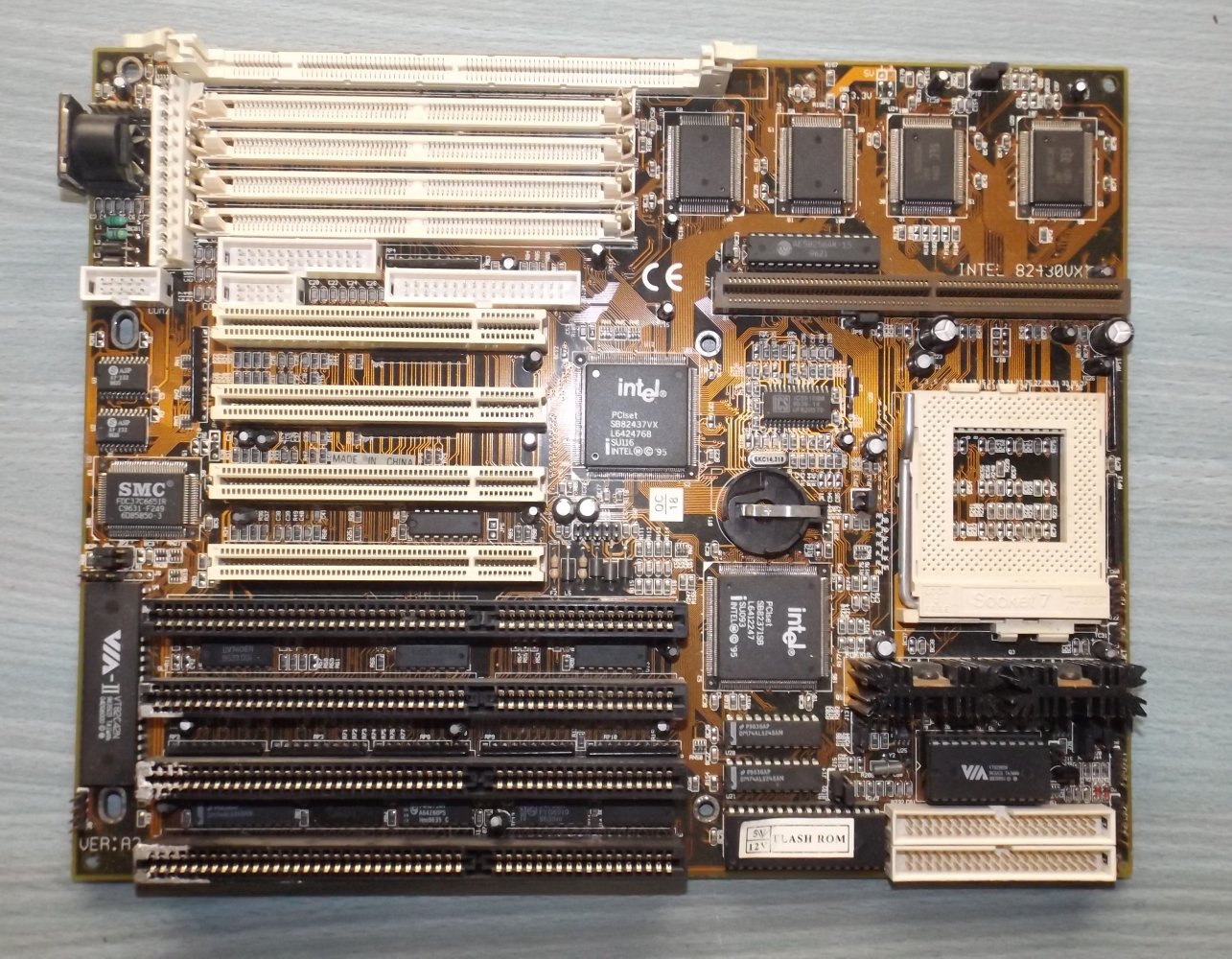

Hello, some hours ago I put back in place this mb (https://4.bp.blogspot.com/-HPRP48X6cos/V2O8bq … Corp%2BP55C.jpg), but despite paying attention (clearly not enough), I connected the mb with one pin left on the right side, then I switched on the psu, it went to protection immediately, then I switched it off after some moments, but now when I power on the system I just get a blank screen with no beeps, on the debug card I just get 0000 code, with or withtout cpu and ram, I noticed that the cpu gets warm anyway.
I tried another cpu, another bank of sdram and another video card, same result...
Did I kill the system for good?

I'm not sure what you mean by "I connected the mb with one pin left on the right side" - which one do you consider right and left? P8 or P9? My guess would be though you've plugged P8 one pin off, somehow, and that put +12V on "key" position. This is usually a missing pin on XT systems to prevent such mistakes but on AT it's another +5V. So the mobo got a surge of 12V on 5V line before the PSU noticed the outputs being wrong and shut down.
So yeah, I'd say good chances are it's toast.
EDIT: Oh and BTW if your memory was SIMMs or 5V DIMM stick then that could be toast too, as well as CPU and any ISA cards. Best to test everything in a known working mobo.

Hm. That would put +12V on -12V pin, short -12V to ground, and short -5V to 5V.
Now, -5V has pitiful current capability so that shouldn't do any damage, unless to the PSU. Make sure your PSU still delivers clean -12V and -5V. Start with -12V as -5V is often just a 7905 regulator on that line.
I wonder if your mobo needs -12V for something important and putting +12V there killed it. By the way, the test card, what does the RESET LED on it do? Does it react to pressing the reset switch? Did you test that PSU with another mobo, maybe you've busted the PWR_GOOD driver transistor by shorting it to 5V.

I can't test the cpu on another board but I tested another cpu (same as the one used on that mb) but same results 0000 and the cpu gets warm almost immediately.
I switched debug card, the second says: ----
Tester result:
+5V: 4,91
-5V: -4,67
+12V: 12,01
-12V: -11,67
Debug card says:
-12V On
+12V On
+5V On
+3.3V Off
CLK On
IRDY, FRAME, RESET Off
Reply 9 of 14, by Deunan
Nemo1985 wrote on 2020-04-30, 00:19:
RESET should be ON briefly after you apply the power, then go off. Same when you press the reset switch. Make sure it works like that.

I did some other testing:
With the ram and without the cpu the debug card shows CLK and RESET ON, while with all the other trying the CLK is always on (or blinking?) and reset off after the first half second, after half minute it start to blink on and off, with all the other setting the CLK is always on while other leds are off.
Since the mb has the RTC socketed (VIA vt82885n), I tried to take it off, I sometimes some burning smell around the RTC area, (where also the mosfets are), I could buy some new rtc or would it be a waste of money?
I suppose something has been damaged to the cpu line but it still get warm if I keep the system on for like a minute...
