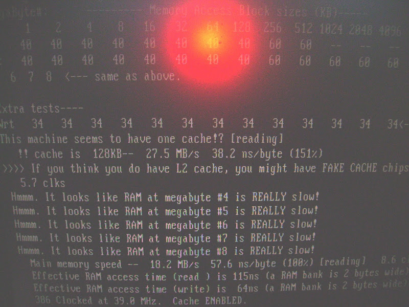

wrote:No Ram amount shouldn't make an impact.
Check the turbo button and also run a CPU benchmark to see if the CPU speed is ok.
Speedsys gives me a processor benchmark of 5.08 which looks about right accordimg to this thread:
386DX40 - Not as fast, as it used to be
where a 386dx40 gives 5.98.
I don't have a turbo button as it's in an old atx case, I'll check the manual for jumpers but speedsys etc all say its a dx33 running at 33 or 34mhz.
I'll swap the graphics card for another and see what happens. I thought this particular speedstar was a tseng et4000 model but maybe it's not.
