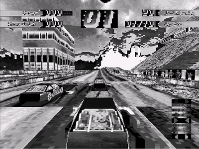

Put together a preliminary software wrapper for Destruction Derby 2 in about half an hour. Feel free to try it out, it only renders the 4 bit textures and only their palette indices, so just black/white, or some other colors depending on your system. But not hard to implement proper palettes, texture filtering etc. No FPS limiter so runs super fast on my modern CPU in a Windows 98 VM. No idea whether the game works on modern Windows, whether some systems would have flicker, and so on. Don't leave the CD in the drive, otherwise you get intro cinematics and an error about no being able to set the DirectDraw video mode.
Seizure warning, if it flickers on your system.

vvbee wrote on 2025-02-27, 11:24:
Nice Work! I tested it on Windows 10 and works "great" using dgVoodoo or DDrawCompat. By "great" I mean this, of course:
The attachment Sin título.png is no longer available
There is also a terrible flicker, as you stated, but the intro movies work fine. Waiting patiently for a more polished version.
