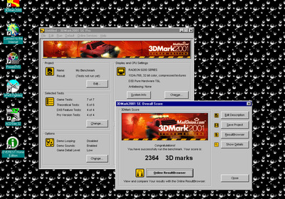

Reply 101 of 120, by Repo Man11
My scores were lower with the motherboard's cache enabled. 3D Mark 2001 was about 200 points lower with the board's cache enabled.

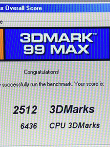

Warlord wrote on 2021-03-24, 03:42:
Bro can you run 3dmark 99 and post your score. This was my score on my socket 7 build. […]
800x600 16bit
file.php?id=88849&mode=view
yep! workin on it :p gimme a sec.
btw, it's confirmed. disabling L2 did increase the score. I'm setting it to disabled again and leaving it.

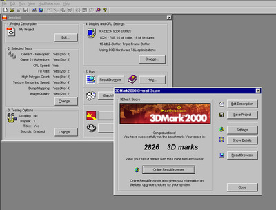

Reply 107 of 120, by Sphere478
3dmark 2000 results
Next up 99

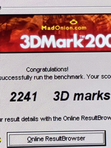

Reply 109 of 120, by Sphere478
Warlord wrote on 2021-03-24, 04:12:
I couldn't get my 450mhz K6 III+ to go more than 500mhz so I expect spheres to be a lot better. Also thats a faster chip-set I think.
I am running at 450
Here is 99

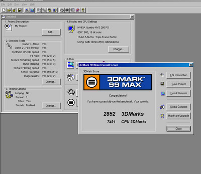

Reply 114 of 120, by Sphere478
I'm thinking of trying the pci pcie adapter with a pci boot card and using the adapter for a x600 and see if I can get that working for science!
edit, won't boot windows with it installed.
tightened one timing I missed lets see if that helps

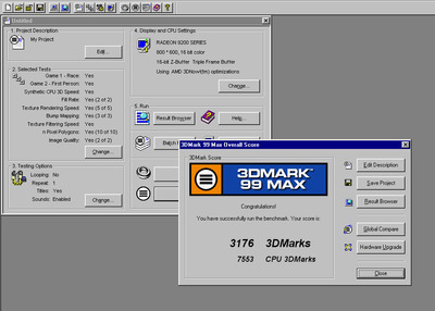

Edit:
2515
6444
helped a little on 99 not much though
Edit 2:
Disabled assign irq to usb in bios and got
2632
6752
What other bios tweaks might help?

Reply 115 of 120, by Sphere478
I’m looking around at fire gl and quadro cards.
I could pick up a quadro 280 and give it a go. It’s basically a fx 5500
What other workstation cards came in pci? Was there a radeon x000 series? Fire gl or a geforce 6 series I could try?
