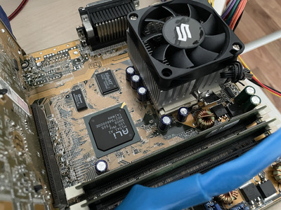

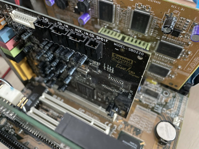

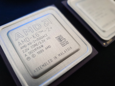

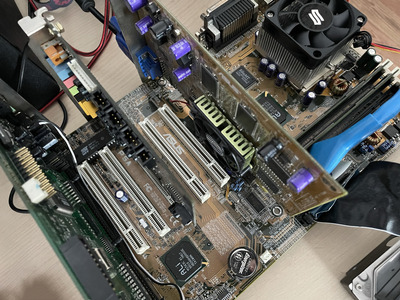

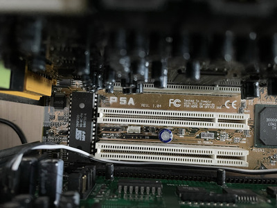

As promised, NEW VIDEO (Asus P5A & AMD K6-2+ 550 OC @ 633 MHz Benchmark): https://www.youtube.com/watch?v=NVUXrRnkrBE
TEST SYSTEM REMINDER:
MB: Asus P5A rev 1.04
CPU: AMD K6-2+ 550 MHz OC @ 633 MHz / FSB105 & 6 multi (2.1 volts)
RAM: 128 MB SAMSUNG SDRAM PC133 (there are actually 2 x 128 MB modules, but only half the size is detected by the motherboard; using more than 128 MB of RAM decreases performance by 5 - 10%, even when using a chip with on-die cache).
VIDEO: Asus V7700Ti GeForce 2 Ti (OC @ GeForce 2 Ultra clocks)
SOUND: Creative Sound Blaster Live 5.1 SB0220
SOUND2: ESS AudioDrive ES1688F (non-PNP / irrelevant for this test).
HDD: Seagate 40 GB IDE/PATA
Sorry, this video is quite a bit longer than the others, since I've decided to first test without sound and then rerun all game benchmarks a second time, with sound. I wanted to show what the performance impact is when using a sound card with slower platforms (even if the sound card actually has DirectSound hardware acceleration). Plus, it doesn't hurt to have the no-sound FPS stats as well, since they can be compared with other benchmarks out there (as far as I can tell, most people usually run these benchmarks without a sound card).
As mentioned previously in this post, just this one time I am using a chip that is more overclockable than usual. Also, as seen in the video, I did quite a bit of fine tuning, so this is not your typical SS7 build, it's probably in the top 1%, or at least in the top 5% (especially since, based on my experience, the Asus P5A is the fastest SS7 motherboard out there), so don't feel bad if your scores are much lower than this - it's normal!
I do plan on testing a more "average" SS7 build (in terms of speed) in the very near future, so stay tuned!
All in all, I hope that @BitWrangler doesn't accuse me of trying to make the SS7 platform look bad, because I literally did everything in my power to make it look as good as possible. 😀
I also plan on redoing the Ezra-T benchmark video, using the updated methodology and game list.
And, a few pics with the test system
