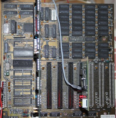

Today I tried to get this XT Mainboard running:
The attachment IMG_9882.JPG is no longer available

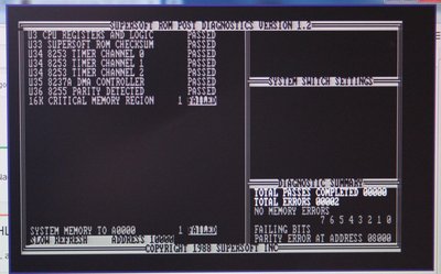

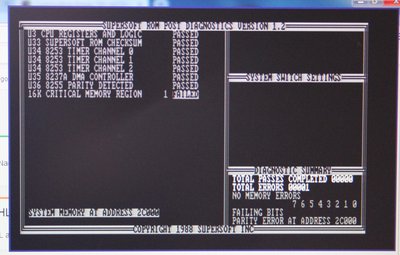

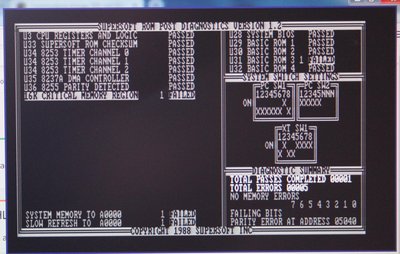

It was looking much worser as I got it and was without RAM, all sockets empty. I fully populated with 5164 and get this:
The attachment IMG_9875.JPG is no longer available
The attachment IMG_9877.JPG is no longer available
The attachment IMG_9878.JPG is no longer available
Somebody has an idea what could be wrong? It says "No memory errors". Seems memory is detected, but with parity errors? I dont think there is a parity switch on a XT? Alread tried all jumpers and DIPs.
Reply 10324 of 30982, by Murugan
Thx 😀
What is that U31 ROM fail?
Reply 10325 of 30982, by Predator99
Murugan wrote:
Thx 😀
I think that can be ignored, that ROM is not required for operation. Problem is only the RAM.

Don't know what it means and it's for a 5150 board but hey 😜...
http://www.minuszerodegrees.net/supersoft_lan … %20-%20Bugs.htm
Reply 10330 of 30982, by Predator99
Murugan wrote:
Predator99 wrote:
@Murugan: You have a really great collection! :cool: […]
@Murugan: You have a really great collection! 😎
Indeed, good idea! Unfortunately it doesnt do anything with the "normal" ROM. Therfore something must be wrong. And I have seen many other similar XT system where this 16k memory test passed without problems.
I also think the installed ROM is OK as the Post-card displays "FF". I also have seen this in many other XTs when the ROM is initialized.
Reply 10331 of 30982, by Murugan
A failing DIP then?

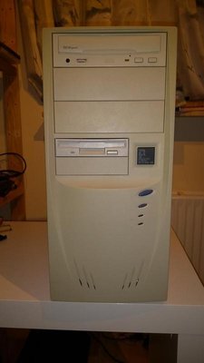

Gave my 486dx33 a different case. And used the case badge, that I have used since 1995.
Not your average case badge, that is for shure. 😁
The attachment DX33-01.jpg is no longer available
The attachment DX33-02.jpg is no longer available
Reply 10333 of 30982, by bjwil1991
Dude, that case badge is amazing. My case badge is an Apple Macintosh Quadra 650 emblem that my dad put on in the early 1990's.
Reply 10334 of 30982, by brostenen
Thanks.... It is a real Amd 286 CPU. It has been dead since way before I got it in 1995. 😁
Intel inside, Amd outside 😉 Like taking the phrase litterally. And not just go and say it.
