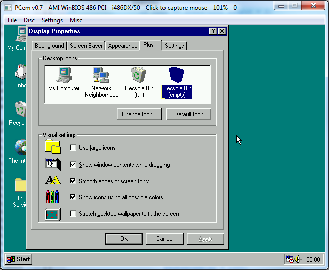

I'm glad the Dogz bug is fixed, though now they tend to flip every few frames or so.
Also Microsoft Plus! installs properly now.

Reply 116 of 1046, by leileilol
I said something too soon, Plus! tab in Display Properties cause a rundll32 crash.
Fixed!
Reply 118 of 1046, by Jorpho
So just out of curiosity, what causes a problem like that?
Reply 119 of 1046, by SarahWalker
Usually for issues in Windows it's bugs with page fault handling, when CPU state is not restored correctly following the faulting instruction. In this case chance stack alignment meant that a far CALL instruction faulted between pushing the return selector and address, and the stack pointer was not restored correctly.
