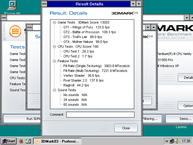

After fiddling with the Negative LOD Bias level in the ATI Tray Tools, I have finally broken the psychological barrier of 13.000 3DMarks in 3DMark 2003 -stock settings- with the overclocked X1950 Pro. By a short margin, but I made it. This overclocked Tualatin rocks!
Breakdown:
My Retro Daily Driver: Pentium !!!-S 1.7GHz | 3GB PC166 ECC SDRAM | Geforce 6800 Ultra 256MB | 128GB Lite-On SSD + 500GB WD Blue SSD | ESS Allegro PCI | Windows XP Professional SP3

@looking4awayout
Windows 3.x window border and start menu ... Which OS is that ? Is this Chicago ?
Reply 11277 of 27724, by looking4awayout
It's Windows XP with Stardock Windowblinds to use the 3.x UI. To me, this is the way Windows should have evolved, as I never liked the 9x UI per se, except for the Start menu.
