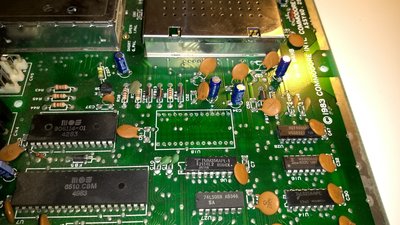

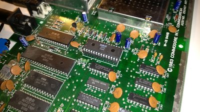

On my breadbin 250407, the SID chip was defect. One voice channel did have sound, yet it was totally off and distorted. So I desoldered the chip, soldered in a socket and inserted a SID that I got for cheap. Now my 250407 board is up and running perfectly again, after a total recap. The next thing I want to do is eighter to get a non-gold capped 12volt VIC-II or create a new and lower sitting 12-to-5 volt socket adaptor.
Anyway... Pic's or it did not happen. (so they say)

The old SID was soldered directly to the board. Now it's gone...

Socket and SID installed....

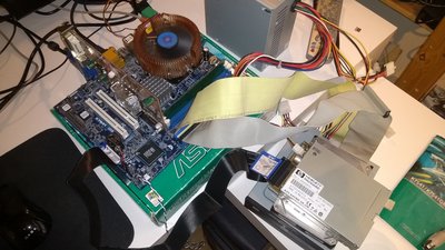

Testing a GeodeNX 1500+ CPU that I recieved in the mail some time ago. I can't really tell by the feel and how it is operating, if this was a fast P3 system or an low speed Athlon. One thing is clearly noticeable, and that is the lack of heat produced by the low power consuming CPU. It never reaches above 32 degree Celcius when I run something, reboot and check temperature in the BIOS. And the cooler just seems cold all the time. In idle, it is running at 27 degree celcius and reaches 28 within 20 minutes after powered on. And this is when I set the cooler for running at lowest RPM.
Test setup:
- Asrock K7S41 (not the GX version, wich sucks compared to K7S41)
- GeodeNX 1500+
- 512mb Ram
- NorthQ all copper CPU Cooler. (with a manual RPM dongle)
- Some non interresting Radeon9600se Card.
- Floppy. DVD-Drive and 40gb ATA-133 HDD.
- Windows98se as the OS.
