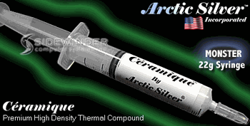

Reply 128 of 237, by swaaye
You should buy yourself the big 22 gram syringe of Arctic Silver Ceramique because 1) it's excellent stuff 2) it's cheap 3) cleans up easy. It will last you forever. I know this firsthand 🤣.
Really any thermal paste is good enough for this old stuff though. The heat just isn't there like with modern hardware. But you don't want anything that dries up or separates and hardens. I've had crap like that from Radio Shack way back.
Reply 129 of 237, by retro games 100
Wow, 22 grams! I'm looking at the syringe I use: a mere 3.5g. It says: Artic Silver 5. I think it's good stuff, man. 😉
Reply 130 of 237, by ux-3
Just use clean needles, will you...
Retro PC warning: The things you own end up owning you.
Reply 131 of 237, by swaaye
Yes AS5 is good stuff and I still have some around here. But it's only (very) slightly more thermally conductive in practice than Ceramique while being several times more money per volume. I'm not much of a believer in the "high end" pastes anymore and just want some stuff that's not garbage like the white stuff in the little packets sometimes is.
