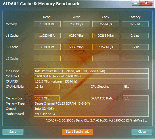

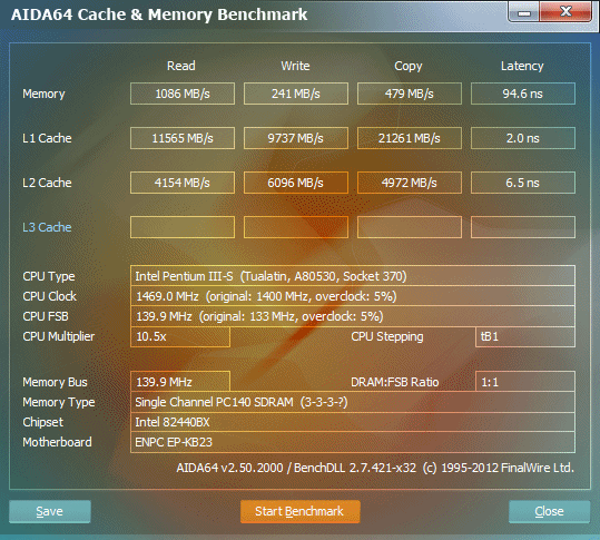

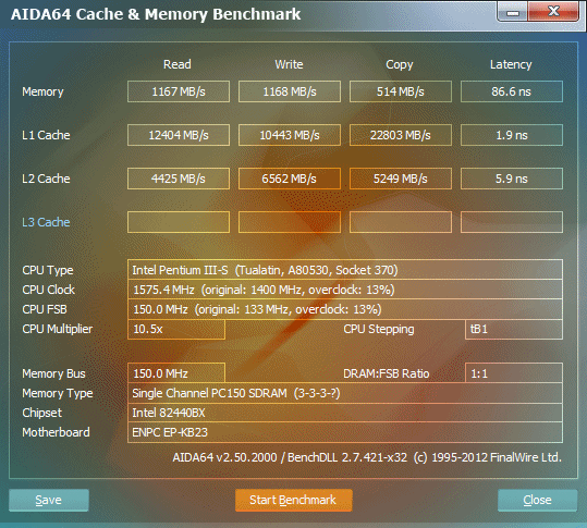

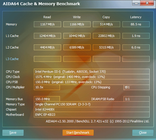

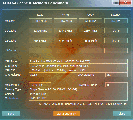

feipoa wrote:
... Is the 440BX stable at 133 MHz? ...
@ 133 :
@ 140 :
@ 150 :
luckybob wrote:
... the 440BX was LEGENDARY for being stable at 133mhz ...
^ This. 😈

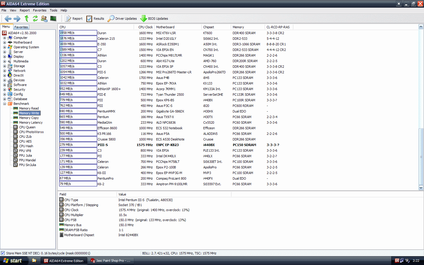

Reply 123 of 311, by d1stortion
What is up with the memory write score increase from 140 to 150?
Reply 124 of 311, by TELVM
Guess it's some tenacious glitch in the Aida64 Cache & Memory benchmark:
The Memory Write only looks more realistic @ 279 MB/s :
Let the air flow!
Reply 125 of 311, by d1stortion
Might report on the AIDA64 forums then. Or try a newer version.

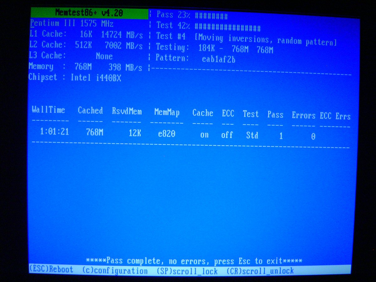

TELVM, can you run MemTest 86+ v4.20 for 24 hours without any errors on the 440BX at 133, 140, and 150 MHz?
Sorry mate but I'm not going to torture this venerable dinosaur for 24 hours in the middle of spanish summer temps 😵 .
Here's one hour @ 150 / 1575 :
Let the air flow!
