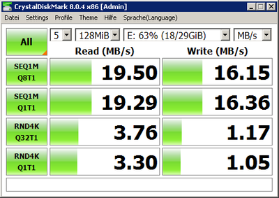

Here are the benchmark results for the different chips.
NED D720101F1:
18.34 KiB

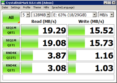

NEC D720101GJ:
18.67 KiB

D720101F1 and D720101GJ are pretty close. I think I had the K6-III+ clocked at 400MHz when I got the result of 18MB/s with the GJ chip.
I assume internally they're pretty much the same. Difference is just F1 is BGA while GJ has legs.
There is another NEC chip called D720100AGM. I think it's the non-BGA version of D720100AS1 and should perform about the same. I did reach 22MB/s with AS1 on a fairly modern system (3GHz Core2Duo). Can someone who has the AGM chip do some benchmarking to confirm this?
Would also be interesting to see how different cards with the same chip perform on the same system. I have two F1 cards, but they're identical and therefore perform identical.
Does anyone have two NEC cards with same chip but different layout?
