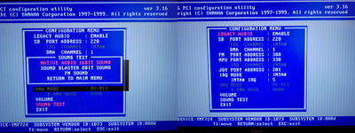

I tried, but I still don't understand if it works
How can i check?

Looks like it is working to me. Without the cable connected, you would need to use DDMA or DSMA.

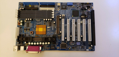

Gigabyte GA-BX2000+
Wake On LAN Header (WOL) & SB-LINK™ connector

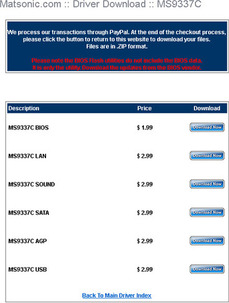

Saw your question unanswered at AtariAge as well. A quick Google search led me to this answer at Fixya. That ms9337c.php is long gone (and will redirect you to an adult-only website; DON'T CLICK!) so Wayback Machine is your friend:
Hmm, that "H/W Sound Blaster Pro DOS Legacy compatibility" sounds promising, but there's no full user's manual to download. What really dropped my jaw was its driver page: user had to PAY for BIOS and driver updates! 😠 I've never seen anything like this ever since every major computer company has updates hosted on official websites free of charge for more than two decades.
I tried looking it up with TRW but there was no such entry called "MS9337C" and none of existing Matsonic Socket 478 MB on TRW looked like "MS9337C" photos I found on eBay. Then I got an idea: what if Matsonic simply rebranded another MB and sold it under its brand name and a new model number? So I combed through all Socket 478 MB with SiS 648 / SiS 963 chipset (which was not very common), along with 1.5V AGP and 5 PCI slots.
And voilà! Turned out its true identity was ECS L4S8A V1.0, and ECS still has its full spec, drivers, BIOS, and manual!

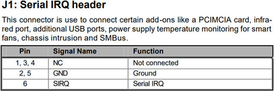

Its J1 header does look like SB-link, down to #6 for SIRQ and #2, #5 for GND, but......
I thought #1 and #4 were GNT and REQ for sideband signal, respectively. 🙄 Maybe someone who knows circuitry better can explain it.

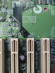

i've got an, ECS L4S8A2 Socket 478, it looks like theres an SB-Link header down by the speaker/cmos battery, cant be certain as the manual makes no mention of it as it doesnt even show that header in the pictures of the board, what do you guys think, i dont have a card with SB-Link at the moment so cant test.

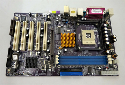

DudeFace wrote on 2024-10-26, 03:51:i've got an, ECS L4S8A2 Socket 478, it looks like theres an SB-Link header down by the speaker/cmos battery, cant be certain as the manual makes no mention of it as it doesnt even show that header in the pictures of the board, what do you guys think, i dont have a card with SB-Link at the moment so cant test.

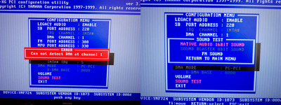

A few weeks ago, I found the ECS L4S8A2 on eBay for a fairly low price (40 euros) and decided to buy it. I had previously managed to get a "Maxi Sound Fortissimo" (YMF-744) for just 15 euros.
Today I finally got around to testing it, but unfortunately, I haven’t been able to get it to work.
I tried the drivers from https://archive.org/details/maxi-sound-fortissimo as well as the ones for the YMF-724 from this Vogons post: Re: Yamaha PCI YMF-724 DOS Compatibility Thread — but no success with either.
Every time (even after running "loadtsr.bat"), I get the message: "Can not detect DMA at channel 1". Changing the DMA channel didn’t help either.
I'll take a look at YMF744, DOS, no DMA? (PC/PCI, SB-link tests) (edit YES DMA, read further down) now. Maybe there's still a solution to be found.
