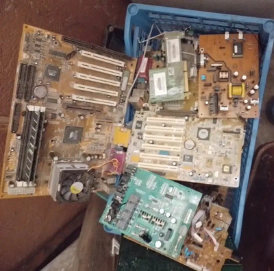

I have this motherboard: https://theretroweb.com/motherboards/s/pcpart … 1-35-8911-xx-xx, mine is from SUPER and works with a AXDA2400DKV3C with fsb 112 mhz(max that the board has, it's a kt133 not a kt 133A board) and with that bus speed it's reported as a Athlon XP2000+. The picture is with the board when i got it.
    122.41 KiB
    887 views
