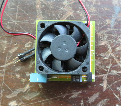

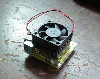

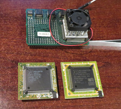

Attached are some images I took in preparation of the BL3 386 interposer hack. Another user commented that the Jaton has only 4 Vcc pins connected, but I won't be sure of the no-name interposer until I desolder the 386DX. Since there are four empty filter capacitor pads on the bottom of the PCB, I kind of assume there's also only 4 Vcc pins going to the QFP.
I've layed out the two interposers next to each other with the VRM on the PCB. The Jaton has the QFP leg over one of the VRM pins, but it might still be possible to use in this fashion. The Jaton does have more vias on the top which could increase the probability of a short. The VRM shown is the AM1117 adjustable.
I've shown a trimmer from my bin, but most likely I'd source a trimmer with a side screw for easier voltage adjustment.
For the Evergreen Am5x86-133 interposer, I noticed that they always use a 100 uF tantalum for Vin and either 8x10 uF tantalum for Vout or 4x10 uF tantalum for Vout (different PCB revision). So perhaps I should copy this approach? If so, then add a 10 uF cap to each detached QFP Vcc lead? The Evergreen interposer also uses the 1117 VRM, but a different brand, EZ1117. Should I add a bypass capacitor to the adjust pin for ripple reduction, and if so, what value? 10 uF? Vout/Vref ~3.

Thanks for the photos and info. It will be really interesting if this stuff makes a difference.
My understanding is that there are only 4 VCC pings connected. I remember slapping on the the under side 10 mF capacitors - there was no observable difference.
It makes sense to use that Evergreen adapter as a guide since there is nothing else out there to follow.

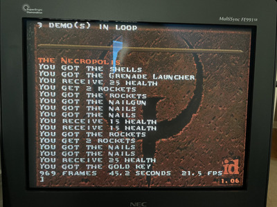

Thanks, that LG stick you sent me got me into windows at the fastest timings! GLQuake crashed though 🤣.
One thing I’ve noticed. In some cases DOS 7 pulls 0.1 better frames than DOS 6.2 on some boards.
I’m able to hit 21.5 on fastest dram timings in DOs 7 on this board.
