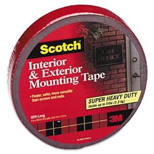

Of course! A jig saw! Yes that would work nicely too. I saw a tutorial here about cutting with a jig saw. The guy literally cut letters out of the case and they came out beautifully. Actually that's a good tutorial for a number of reasons, it's where I picked up the Dremel scoring trick. Before that I used to be impatient and just cut as I went (which also works, but scoring the metal first is much easier).
And I know what you mean about the waffle style grilles in cases being difficult to cut out straight. Half the time they are punched larger than the diameter of the fan blades, often in a non circular pattern like a hexagon. There's no good way to remove them and make it look like they came that way from the factory, and sometimes not a lot of space to drill holes for the screws to keep the fan on the case.
The other trick i use is this double stick tape from Scotch. It's sort of a gel plastic based product and doesn't dry out, making it much better than the foam based stuff (that dries out after a few years and requires a scraper to get off). Since it's a jelly like substance, it also dampens vibration, so it's perfect for mounting fans to thin steel or aluminum cases where the case would pick up that vibration. I've used it to mount fans, panels, hard drives, you name it, and none of it comes off on it's own, yet comes right off when I want it to. Careful not to cover too much surface area though or you'll be pulling on it with all of your strength and then some to get it off. It's similar in consistency to the stuff they use to hold body panels on cars (though a bit less sticky), to give more of an idea of just how strong the adhesion is.

The hint with the tape is a good one! 😉
I never even knew it existed, next time I'm in one of those "hardware" shops, I'll definitely go look for it, it sounds useful 😉
