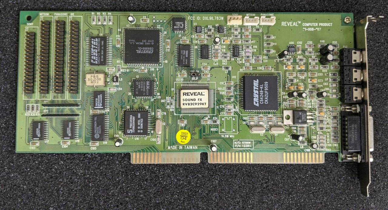

Hi! Can you upload the drivers for REVEAL / SOUND FX WAVE (SC500)?
I've just bought this which seems identical to yours, but can't seem to find the precise drivers online.

Extract the contents of the attached file to a directory entitled SOUND16, then use these lines in your autoexec and config:
autoexec:
rem *reveal sc500*
SET BLASTER=A220 I5 D1 T4
SET SOUND16=C:\SOUND16
C:\SOUND16\sndinit /b
SET PATH=C:\;%PATH%
PATH %PATH%;C:\SOUND16
config:
rem DEVICE=C:\SOUND16\cdsetup.sys /T:X (for CD use)
I also think that UNISOUND will work with this card.

Thanks!
