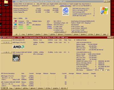

Reply 162 of 1037, by xjas
red-ray wrote:
No problem, this may well be why the Voodoo 3 is as it is, but there is no support for your ATI card at all, further I an not 100% sure exactly which card it is, I think it may be https://www.techpowerup.com/gpu-specs/3d-rage-pro-pci.c1717, is it? If not can you post a link to what it is please?
I just checked and my Voodoo 3 is OK on Windows Me, but it's the primary display. If you still get the incorrect clocks with Beta-10 please can you try with just the Voodoo 3 installed? When I checked Menu->Machine->GPU Info all the registers contained 0xFFFFFFFF which makes me wonder if the card has been initialised.
Thank you.
Reran with Beta 10, but got the same result. I'll try the V3 as primary video & on its own when I get the chance...
The exact Rage card I'm using is a PCI Rage LT Pro 8MB with a part number 109-54100-00. There were a lot of confusing variations of this chip, and my card doesn't look exactly like the one on the Techpowerup page, but the specs should be similar.
Edit: the Voodoo card has definitely been initialized, since it's running a second display and the desktop is spanning across both. (See this post...)

Reply 163 of 1037, by red-ray
Thank you for running the tests and the link. I have added support for the PCI Rage LT Pro 8MB to the Beta-11 SIV that's attached to SIV support for 386/486/586 class + Alpha CPUs and 3dfx + S3 + SiS + Matrox + XGI + old ATI + NVidia GPUs - Testing Help, how does it do?
I have also added some code that should detect the 0xFFFFFFFF and not show the clocks, but I can't see why it's FFFFFFFF in the first place. What speed does the 3dfx utility report? If you have HWiNFO what speed does it report?
Can you select AGP VGA rather than PCI in the BIOS and if so what happens when you do? I tried selecting PCI VGA on my system, but it still posts to the Voodoo 3 which I guess is down to a bug in the TYAN S2466 BIOS.
Below is what get's reported for my Voodoo 3 2000 and yours should be similar. Do you have Windows NT/2000/XP/2003 on the system and if so what does SIV report if you boot that?

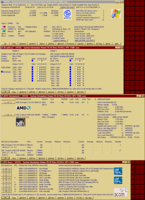

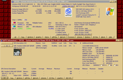

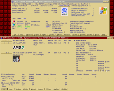

Reply 176 of 1037, by xjas
As promised, here's results from Beta 11 in all three configurations: RAGE PCI card as primary (and the desktop spanned across both GPUs), Voodoo3 AGP as primary, and Voodoo3 on its own. It seems to be picking up the correct data from both when they're set to primary now, but it still clocks the Voodoo3 at "0MHz" when it's the secondary card. BTW I also confirmed the 125MHz V3 clock with HWInfo and in 3DFX's own properties utility.
(One thing that's bugging me a little is the reporting of ATI cards as AMD cards - this wasn't the case until ~2006 when the buyout occurred, and the branding didn't even change until the HD6xxx series around 2010 AFAIK. It's not a big deal, but "AMD Rage" just looks wrong. 😉 I imagine the device ID code is already full of if...then case statements, but if you want to change that, it'd be a little more accurate.)

905 views
^^ Rage as Primary GPU - reporting 3DFX @ 0MHz

907 views
^^ 3DFX as Primary - both cards report correct(?) clocks

Reply 178 of 1037, by red-ray
Thank you for running the tests and generating the files. These confirm that the issue is the PCI Command register being 0x0002 rather than 0x0003 is the root cause of the issue. Is there any reason for having the Rage as the primary VGA device?
I could get SIV to enable I/O Access, but feel I should have a think about this before making any changes, epically so as I plan to release SIV 5.42 tomorrow. I suspect it would be wise to wait 'till you have figured out why your get the 125 MHz rather than a 143 MHz clock first, what do you think?
BTW for the 3dfx the RAMDAC Clock is the current clock so if you change the display resolution this should change.
