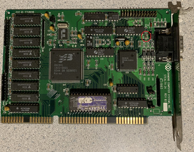

Reply 16102 of 32086, by canthearu
I received my Stealth 24 ISA video card a few days back.
Was very disappointed in the display output originally .... very dark.
After much research, I deduced that the RAMDAC wasn't getting the correct reference for creating the RGB signals. Generic comments on the internet suggested it was a voltage reference, but after working out that my RAMDAC - Diamond SS2410 is a rebaded MU9C1880 DAC, I was able to find the datasheet.
From the datasheet, I found that it actually is a current drain called IREF, rather than a voltage reference, and that it would typically connect to a regulator with a resistor across it's pins. I found the regulator hiding behind the VGA plug, and looked at the resistors nearby. Measuring the resistor behind the regulator resulted in a very high resistance. Not convinced at first that this was the problem, I decided to touch up the solder in case it was just a cracked pad. However, when touching up the solder the resistor fell apart, signalling that it might have been the problem.
To test this, I plugged it back in, and sure enough, the picture was still way dark.
Next step was to find what size the resistor was meant to be - 1820 seemed to be the code on the original from photos I could find online. That is 182 ohm.
To replace the broken resistor, I started testing out resistors on an old winmodem card with similarish size resistors. I found and started out with a 1k ohm resistor ... not too low, didn't want to cook anything incase I was wrong about the original's markings. It seemed a bit brighter when I plugged it in, but not really much difference. But there was no fire or bright sparks, so onward I went. After accidentally putting a 1.5k ohm resistor in I thought was 250 ohm, I found what I was after, a 180 ohm resistor. So I took it off the old winmodem and soldered it onto the Diamond Stealth 24 ISA card.
Now with a pretty close to correct resistor in (177ohm, within typical spec) place, the display output has been restored to pretty much correct brightness. No longer are whites a dark, muddy grey!
The attachment s3diamond.jpg is no longer available
Admittedly, it is a pretty bodge install of that resistor ... but I don't have a hot air gun to even it out and don't really want to mess around with the pads too much otherwise it far too easy to start lifting them or start destroying the components!
Now to chase down the ebay seller for selling a junky card to me saying it worked perfectly!

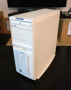

Reply 16105 of 32086, by wirerogue
had some black scuffs on both sides of my dell xps m233s.
some magic eraser got most of them off. probably could have done better but, my arm got tired.
The attachment dell.xps.m233s.b.jpg is no longer available
The attachment dell.xps.m233s.a.jpg is no longer available
Reply 16106 of 32086, by chrismeyer6
That case cleaned up beautifully and it doesn't look like it's yellowed at all. I've always liked the looks of those Dell XPS cases.

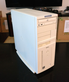

Reply 16109 of 32086, by wirerogue
chrismeyer6 wrote on 2020-07-05, 19:07:
after looking at the photos i posted, it occured to me that i have a brand new mitsumi floppy drive with a better beige than the alps floppy drive that was installed.
perfect match.
The attachment dell.xps.m233s.jpg is no longer available
Reply 16110 of 32086, by PD2JK
canthearu wrote on 2020-07-05, 11:01:
I received my Stealth 24 ISA video card a few days back. […]
