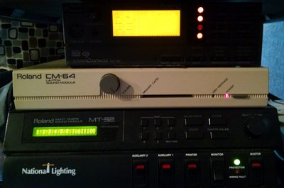

Reply 16974 of 56748, by HunterZ
CM-64 arrived today in working order and joined my SC-88 (non-pro) and MT-32 (old). I think I'm covered on MIDI for DOS games now.
I also tested for the clicking bug and it doesn't seem to be affected. I'm not sure if that's a CM-32L-only problem or not.

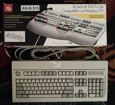

Reply 16978 of 56748, by creepingnet
Bought an NEC keyboard and a brand new in Box Windows 95/98 keyboard that's also AT and somewhat clicky as well (complete with palm wrest). Set me back around $55 at Re-PC.
The attachment IMG_20170513_222932666.jpg is no longer available
The NEC keyboard is interesting, has a feel somewhere between a Chicony or Northgate with Alps Keyswitches, but a bit quieter and has a slight bit of Model "F" feel to it as well. I think this is my new favorite of the now 4 clicky keyboards I own.
