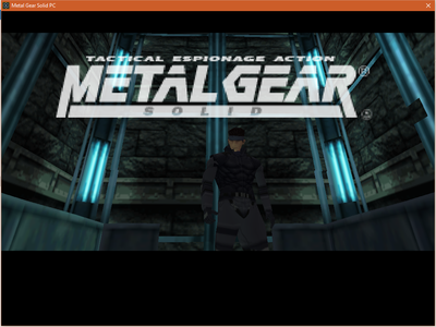

Hello,
Thanks to some hex editing, I have now a working copy of the french version of Metal Gear Solid 1 for PC.
This modification is based on the modified executable for the english version named "Metal Gear Solid - NoCD Fixed Exe - Win XP-Vista GeForce-ATi FiX by MerolaC".
Putting the modified english executable on top of a french installation didn't work because (as I read here : http://forum.xentax.com/viewtopic.php?f=10&t=5491&start=15 ) the game checks for the size of various data files at runtime to prevent modification. If the sizes don't match what's expected, the game crashs (and indeed, it crashed alot). And of course, the data files are different, so the executable has to be diferent.
Anyway, this modified executable was tested successfully on Windows 10.
It's benefits are that the game works on modern Windows, and with beautifully accelerated graphics. 😀
Here is a screenshot :
697.94 KiB
5673 views
screenshot
Using dgVoodoo2 with an earlier version of the executable (the only modification was that the SecureROM DRM was removed since Win10 is incompatible with it) didn't prevent the game from reporting that it "didn't find a suitable graphics card and will be using the (ugly) software mode"
Whatever config of dgVoodoo 2.51 I tried (the game uses DirectDraw 7), the outcome remained the same.
In the game folder, here are the dgVoodoo specific files' names :
D3D8.dll
D3DCompiler_43.dll
D3DImm.dll
DDraw.dll
dgVoodoo.conf
However, with the fully modified executable one last problem remains : fullscreen mode always has the window chrome/frame around it.
Which goes away the instant dgVoodoo2 is used. In other words, dgVoodoo2 enables true full screen.
So I'd like to ask for permission to ship dgVoodoo2 along with the modified executable in a game patch for the french version of MGS 1 for PC. (I will mention dgVoodoo2's original source and download link too, of course).
Is it possible ?
Thank you very much for dgVoodoo2. 😀
On the subject of Metal Gear Solid, that still has water rendering problems with hardware acceleration turned on.
It's still subject of investigation because one time the water renders with z-fight another time it renders nicely without any glitch. I don't yet understand its reason.
