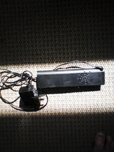

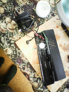

My HP/Compaq CQ62 desktop set up was over heating in the warmer weather here. I suspect part of the reason for the over heating was trying to charge a completely dead battery pack. Because this system doesn't need battery pack I pulled the dead one out and dissected it, remove the cells and the small circuit board and sensors.
Once I had it apart I decide to make a fan holder out of it with a pentium 1 era SOYO 12 volt cpu fan. This fits into the battery pack nicely after some cutting if the plastic. I drilled holes in the bottom cover for the fan to draw fresh air in. I attached stainless steel mesh from an old Honda motorcycle , which I stripped many many years ago, air box with black silicon sealant. This will stop insects and other items from being sucked in. Drill holes in the top half of the battery pack were I knew they meet up the latch openings in the CQ62 where the battery pack will attach and lock in to place.
Searched through my wall wart box for a suitable 12v DC power supply. Used a bit of 32 thou lock wire bent in two and soldered to the black cpu fan lead and inserted it into the center of the psu connector with some insulation around it so there is no direct short with the other connector. Grabbed a eyelet connect from my electrical connector box which was a bit smaller than the outside of the psus outer contact. Cut most of the eyelet part off leaving a 5mm x 3mm tap I could solder the Red lead from the cpu fan.Also spread out the circular bit so it fitted on the outside of thge psu connector nice and tight. Got a piece of soft rubber clear tubing and fitted this around the outside of this.
Connected the psu to the cpu fan connector I'd just made to see if it functioned correctly. It did. Applied black silicon sealant to keep the fan in place, made a cut out for the psu connector in the bottom half of the battery pack and then seal the two halves together with black silicon sealant. Wrapped masking tap around the battery pack halves to keep them nice and tight against each other then left the unit out in the sun on the fence railing for a few hours. Removed the masking tape then retested the unit. Fan is working fine-Good. Now I can fit the unit to my CQ62 desktop set up, plug the psu into a spare electricle socket, turn it on and have extra cooling of I need it.
Edit 25--2021: Tested the unit today and there is quite a reduction in on my CQ62 desktop setup.

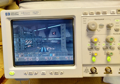

Played Quake on HP Infinium oscilloscope. It is built for that, what else?
It was tempting to install a Voodoo I but I could hold myself. (In that case I would have to use external monitor.)

🤣. That's genius 😀
Reply 17950 of 30157, by chrismeyer6
How's the frame rate on the scope playing Quake?
Reply 17951 of 30157, by fool
chrismeyer6 wrote on 2021-01-24, 16:08:
I didn't look but it's good. It was the first game I could find on that occasion.
That thing has AMD K6/200 + CHIPS video (T65550?) + 32MB RAM. I replaced mainboard (standard babyAT) because the original had a flat Dallas RTC.

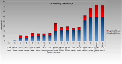

Just benchmarked all of the CF, SD and Micro SD cards in my box of spares.....
The attachment FlashMemoryBenchmarks.png is no longer available
Write performance on the lot of them sucks, as a ratio of read performance, apart from an older Sandisk Extreme IV card which almost has equal write performance as it does read.
Have been setting up a couple of CF cards for my 286 benchmark shootout, as well as a recently rebuilt 486 PVI-SP3, and I wanted to go CF for both of them. Copying several dozen gigabytes (of relatively small DOS game files) onto flash media sucks, even with some of those later cards.
I'll probably go with one of the later Kingston 266x or Sandisk Ultra CF cards from the right side of the chart for the 286 (both are 16GB), and get a 64GB Sandisk Extreme for the 486. Not for the performance in their intended systems, but my own sanity when setting them up or restoring them.

That's really cool. It's also fun that HP used standard pc components for making that line of oscilloscopes.

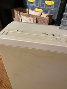

Over the weekend I put together a 486 SCSI system:
DX2/66, 32 Mb RAM, 256k cache, 1.08 gb Quantum drive. In this picture, AHA 1542CF, and a 16550 dual COM card (from an NCR POS - I had to set the jumpers properly as they were set for addresses for COM 3 and 4 and IRQ 3 and 12, respectively). The CDROM is a Pioneer 32x SCSI.
This case had a P166 in it, but it seemed visually closer to something that might house a late 386 or early 486, so I pulled everything out and put this together in its place.
The board came bundled with a Token Ring LAN card (pretty useless, but it's in there), and a TEKRAM IDE/FDC cache controller, which I could not get to work. It's going in there anyhow because I have no use for either of them anywhere else, and I wanted the "one card in every expansion slot" just like old XTs. Theres a Trident 9400CXi with 2Mb , a CT2230, and a high speed LPT card set to ECP mode as I will be using an external ZIP drive on it.
Friday night:
Played this with my son for an hour or so (Stunts) - he loves it. He's not old enough to understand drinking and driving, but when he's old enough to, I will tell him that this is the only permissible form 😉
I took my front panel apart to insert a 7 segment display, and there was a hole, but the front cover had the black sticker/vinyl cover going over it. Exacto-knifed it off
and put the display in there:
Normally I have a red gel that I put in to change the colour of the LEDs, but all I had was this deep green plastic from my Sonata's digital clock (replaced with one from an Elantra - long story but 4 OEM Sonata clocks were NFG at the wreckers - seems it was a design flaw, I've got ones out of Ponys that still work to this day) and it was the perfect height so I snipped some off to length:
I put some clear glue on the LED itself (it's pretty tight in there) and this is what I got:
With Turbo off:
with Turbo on:
Overall I'd say 8/10, I could have been a bit more careful with cutting the vinyl, and the display itself is off on a slight angle due to the reset switch embossment hitting the PCB (I couldn't clip off more without damaging traces)
The IBM badge case is off a defunct server thrown out at work.
Next up - wait for the retrobriting to be done on the 5.25, hook up the speaker, bring out the NCR 17 inch and film it for my channel.
I have so much raw content 🤣... need to sit down and edit it!
