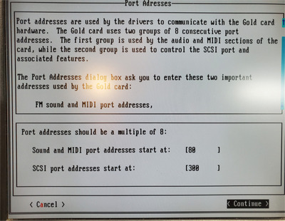

Reply 182 of 199, by Shponglefan
awgamer wrote on 2023-08-17, 02:21:
Could probe things from software, card found by gold install/test software? init work?
It's not detecting at all, that's the issue. If I run the basic Adlib Gold drivers, it says no card is detected. It's also not being detected by games.
I even attempted a control chip reset (per instructions listed earlier in the thread) multiple times to no avail.
I've also given it a quick inspection under the microscope and no obvious damage, bent pins, or anything else particularly obvious. And tried repeatedly cleaning the contacts just in case, but they're pretty clean to begin with.

Reply 186 of 199, by carlostex
Shponglefan wrote on 2023-08-17, 00:38:
Unfortunately my GoldLib appears to have died. :( […]
Unfortunately my GoldLib appears to have died. 🙁
I was testing it in a 486 DX-33 build. Initially it worked and I was able to detect and configure it just fine.
I'd been adding and testing other sound cards. At the time I was mainly working with the AWE64 and Yamaha Audician 32. Then went back to try the GoldLib again, and it wasn't working anymore. The Adlib Gold setup program won't detect it.
I tried removing everything and just testing the Goldlib, but it still wouldn't detect it. I tried it my other 386 DX-40 system, it won't detect there either. I tried the control chip reset instructions listed here (three times in both systems). Didn't help.
I also confirmed that my original Adlib Gold card works in both setups (386 and 486). So it doesn't appear to be a system specific issue.
I did a cursory inspection for any physical damage, but didn't see anything immediately obvious.
Any suggestions on anything further to try?
Did you change the AdLib Gold port to something other than 388h? If you did, and have the jumper config in single port mod, the AdLib Gold software won’t find the card anymore and it will feel that the card is dead. I had to do one of 2 things:
- Either change the card for dual port mode, where the card will respond on 2 different ports (the one you set the card to and fixed 388h) by changing the jumper to the middle and lower pin;
- Patch the software you want to use for that new port address you set your card to, there’s just no other way;
I always thought the card’s software would look to the SET GOLD environment variable, but that never helped me and seems to happen only when the jumper is set to dual port mode.
I finally decided to have my card on 398h with IRQ 4 and now the card co-exists peacefully with a Pro Audio Spectrum just fine. Main drawback is that i ran out of DMA channels, making me wish i had the MMA also wired to DMA 0 which would require the 16 bit connector part to exist.
Patching the software wasn’t a huge drawback to me since most game support for the GOLD is via sound libraries such as the AIL2, DIGPAK, HMI SOS etc… Cool thing about the AIL2 drivers is that I still have digital sound without a DMA channel set, but alas, other libraries can’t play without DMA. That’s a consequence i was ready to accept.
Dune is an excellent test for the Gold because the game IMO was very well programmed and it follows the instructions you give to it. When you provide the base address of the Gold to the game it really uses THAT range. When i changed my card to 398h and the Gold drivers stopped finding the card i tried Dune with the port I set it to and the card was working fine. That’s when i realised what was going on.
I recommend you set the jumper to the bottom position to set the card to dual port mode and try the AdLib Gold drivers before trying anything else.
Reply 187 of 199, by Shponglefan
carlostex wrote on 2023-08-17, 05:46:
Success! Thank you for suggesting this, it did the trick!
For some reason, the port was set to 80 and the SCSI port to 300. I had not changed the port myself (and certainly not to these values). IRQ settings had also been cleared (previously I had it set to IRQ 3).

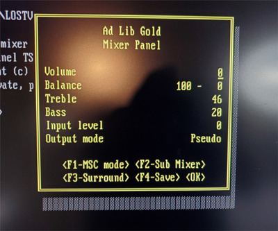

Mixer settings were also messed up with volume set to zero, and the L-R balance with L set to 100.
446.47 KiB
2106 views
In subsequent troubleshooting, I did notice a couple more issues:
1) Initially the mixer would lock up on me when trying to write values. However, after repeated attempts, it seems to be working again.
2) Mixer values don't save the entered values for volume, treble or bass. It always saves a slightly lower value. However, this does appear to be "normal" behavior as my original Adlib Gold on my 386 does the same thing.
I also did another control chip reset for good measure. This worked this time and reset all the internal settings back to defaults.
Did a couple more hours of troubleshooting and everything seems to be working okay. Tested a variety of games including Dune, KGB, Arkanoid 2, Space Quest 3, Settlers, Warcraft...
Only issues is I notice that Dune changes the mixer settings (it sets volume to 97 and changes treble and bass). And Warcraft's FM music seemed a bit quieter than other games.

Reply 188 of 199, by Shponglefan
keropi wrote on 2023-08-17, 04:58:
That is weird... Time to send it back for checking/repair then - send me an email to arrange it !
Good news, it seems to be working again! I tried carlostex's suggestion of changing to dual port mode.
For some reason the port had been changed to 80, along with changes to other settings.
I did get some subsequent mixer lockups when attempts to write changes to memory. However, even that issue appears to have subsided for now. I've probably changed the mixer a couple dozen times in a row. Other than the values not writing correctly (which also happens on my original Adlib Gold), it does seem to be working fine.
I'd be really curious as to what caused this in the first place. I do have four other sound cards in the same system (Yamaha Audician 32, AWE64, MPU-401AT and a Primax Soundstorm). Not sure if it's possible for something else to have written to the GoldLib and corrupted its settings?

Reply 190 of 199, by Tiido
Most cards drive the signals in push-pull fashion so sharing is not going to be possible. In theory if cards used open-drain or source signalling, and didn't try to use same resources simultaneously, it can work. DMA sharing jumper on some of the SB cards probably does just that but if you have just one card this way, it isn't really enough...
Reply 191 of 199, by keropi
Shponglefan wrote on 2023-08-18, 00:52:
Good news, it seems to be working again! I tried carlostex's suggestion of changing to dual port mode. […]
oh that is good to know
so basically the configuration eeprom data became corrupted somehow but it is good to know the way to come back from this
no idea what caused it, perhaps the hardware combo triggered something.
I have also noticed the mixer app saving a bit lower values... another oddity/bug I guess
