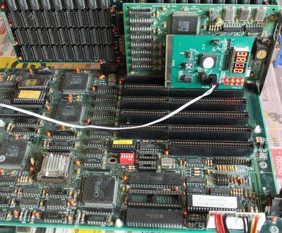

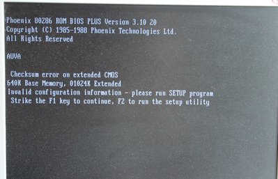

Predator99 wrote:
Yes the board has an external battery header. I connected 3V to it (do not have something better at the moment) but it didnt cha […]
bjwil1991 wrote:
Or a 5.5v memory super capacitor can be used in placed of the NiCd battery, or using a cordless phone NiMH battery pack to the motherboard (mounted somewhere safe, that is) since some boards don't have jumpers for an external battery pack.
Yes the board has an external battery header. I connected 3V to it (do not have something better at the moment) but it didnt change anything. Never seen a board that requires a battery connected to power on...
I am almost sure POST passes the 1st time I turned on the PC as I heard the seeking noise from both floppies. I think the VGA didnt initialize because the 5V trace was already broken, therefore the screen was black.
Hope I didnt destroy the board by powering on with a shortage...
Sounds like you have better engineering background to troubleshoot this. Usually if you see a spark or smoke or smell smoke that's a bad sign and it happened once when I inserted my 8-bit Sound Blaster into a 486. Luckily whatever popped or smoked didn't kill the Sound Blaster.
But I'd try all the methods I have outlined to troubleshoot but if it already fried I don't see any more harm it could do hooking up the PC internal speaker and removing your diagnostic card. Use a cheap VGA 8-bit card and hook it up to a monitor. You can forget about hooking up the HDD/Floppy controller. It should still boot up or count the memory with ticks. Now if it doesn't show any video output or hear any ticking on the PC internal speaker then it could be the CPU or the onboard memory is not installed or possibly one of the chips is defective causing it not to start the memory count. Oh you'll also need to hook up a 5 PIN DIN keyboard to see if the keyboard LED lights turn on for Caps lock, Num lock, and Scroll Lock. If this doesn't light up on the keyboard or able to turn it off and on then you might have more serious problems.
What was the 8-bit diagnostic board you were using in that picture?
It is this card here
http://www.ebay.de/itm/PC-Motherboard-Analysi … 74AAOSww9xZCzXI
and its working perfectly. Speaker is integrated.
As for this board is stops with
- Phoenix (02)[Beep]=1-1-3 CMOS write/read test in-progress or failure.
- 1-1-3 CMOS read/write error The real time clock/CMOS is faulty. Replace the CMOS if possible
Low 1-1-3 Extended CMOS RAM failure The extended portion of the CMOS RAM has failed. Replace the CMOS if possible
- 1-1-3 Your computer can't read the configuration info stored in the CMOS. Replace the motherboard.
and the corresponding number of beeps, it doesnt make any sense to try with a VGA installed. It is the second step of the POST procedure...no video initilization done yet.
This error seems to be related to the CMOS itself, integrated in the P82C206 in this case. Not the battery.
But I also tried with 5V now and no change...
Currently I have also some trouble with the MFM harddisk Seagte ST 251-1. Seek tests etc are working perfectly in the diagnostic program and it sounds good. But when I try to read/write on it it doesnt work. Will try a low-level format later.
EDIT: Cool, low-level format did it. Now booting from the ST-251 😀 Strange, was thinking this is only neccessary when using the disk the first time. Also played with the intervealve but it was not possible to read anything at all before the format...

Reply 18111 of 59750, by Predator99
Predator99 wrote:
It is this card here […]
95DosBox wrote:
Sounds like you have better engineering background to troubleshoot this. Usually if you see a spark or smoke or smell smoke tha […]
Incredible news...board is also running again 😀 😀 😀
What did I do...dont know. I tested the board with an AWARD Bios from another board to see where it stops. It was at 12 14 - also seem to be related to the 82C206. Therefore I checked the voltages on that Chip (VCC, VSS, PWRGOOD, TEST) and also noticed that the Reset line is only high when performing a hardware reset. Everything with cabling seemed to be OK. Therefore I switched to the original Phoenix BIOS again.
In between I noticed that I inserted the Diagnotic card in that not-ISA RAM slot again...and it started to smell 😵 🙁 (Catastrophic design of this feature!!) Therefore I put it in another ISA-slot and was happy that it was still running. But now it displayed surprisingly 06-08 which indicated a RAM failure.
Therefore I inserted the RAM card and the VGA...and the board is powering up gain...
Somebody able to tell me what the repair step was? 😀
The attachment IMG_1138r.jpg is no longer available
The attachment IMG_1141r.jpg is no longer available
The attachment IMG_1142r.jpg is no longer available
Reply 18112 of 59750, by yawetaG
Bad contact between the legs on the BIOS chip and the socket: removing and reinstalling fixed the issue. Possibly.

Reply 18115 of 59750, by Predator99
Yes, I think this is a good explanation...

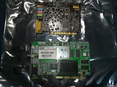

Reply 18119 of 59750, by rick6
Bought these two for 10€ at a local shop. ATI Rage Theater 128 along with a SoundBlaster 5.1 Live!
Fair price or not? (haven't tested it yet, i hope they work 😀 )
