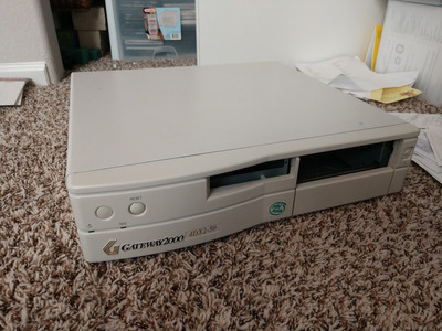

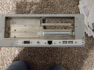

Some friends of mine 3D-printed a custom IO panel for my sleeper build. I’m retro-fitting this Gateway 2000 low-profile 486 (don’t worry, I restored and preserved the 486 parts) into my new workhorse computer.
The IO panel for USB, networking, audio-out, and HDMI turned out great! I can’t wait to get the rest of the build in place.
The case is now just about ready to host an 11th gen Core i5 as soon as I can get one. I’ll fit the mini-ITX motherboard with new stand-offs next weekend.
I just wish I could buy a modern video card to make this build truly special. That part will have to wait a bit longer.

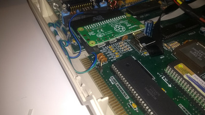

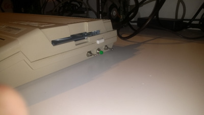

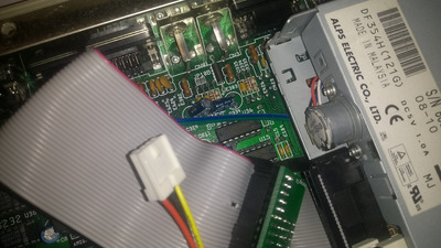

Did some more Amiga related stuff today. As I have installed one of the RGB-to-HDMI adaptors in my Amiga500 Rev. 8a.1 machine (full ECS chipset). And I installed a push button in my Amiga500-PC-Case convertion the other day. Then why not install a button in my 500 that are in standard case. I installed the button between the boot selector switch and the Kickstart Switcher. That way I have access to all these mod's right below the Floppy drive. The nice thing about the standard Amiga500 case, is the there are rooms for stuff like flat-cable (the HDMI output) and wires between the bottom shield and the Floppy drive.

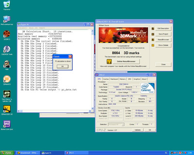

Made 1.73ghz cpu for my 440bx system ( asus cusl2 for now).
Even doom 3 and halo are playable. I believe this cpu is faster than p3-s 1.4ghz, but mine died so I can't check.
