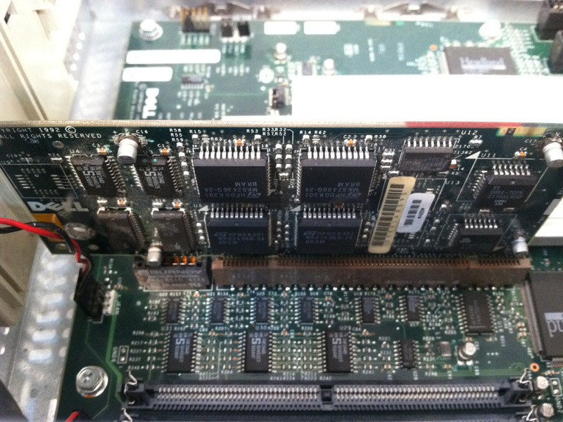

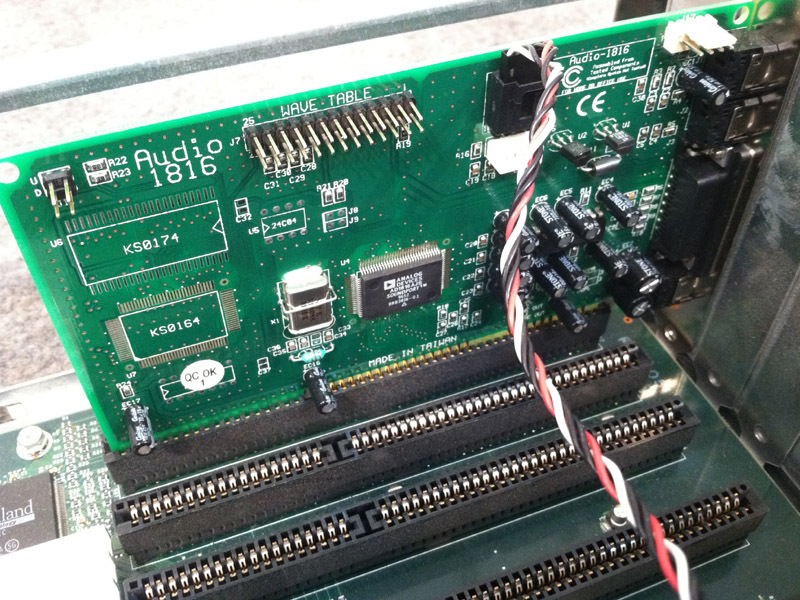

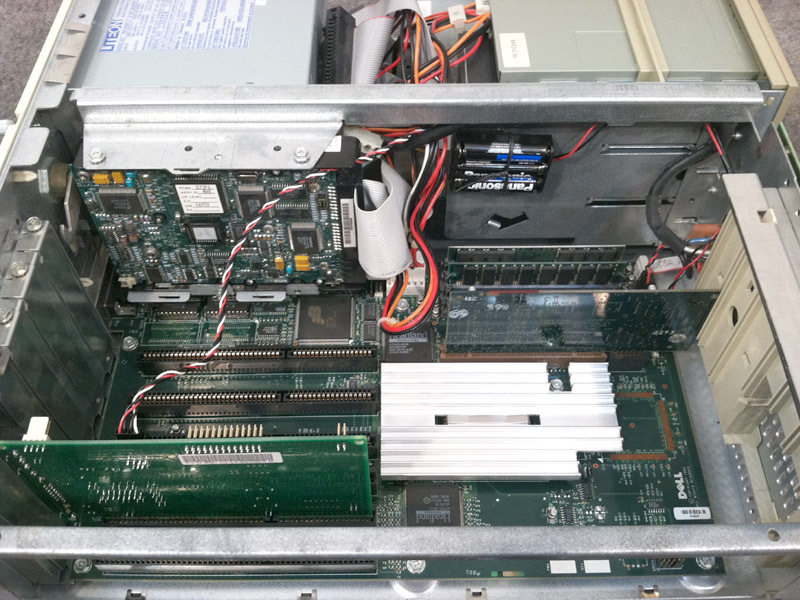

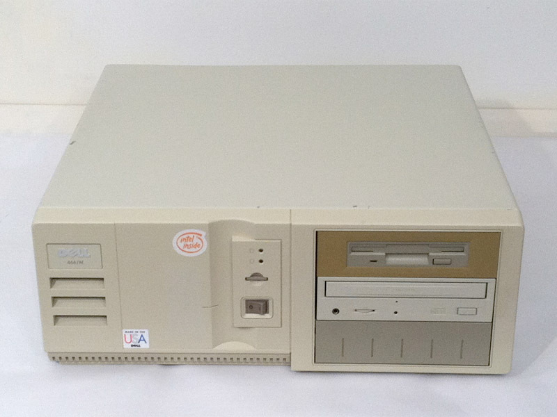

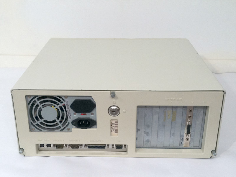

Picked up this Dell 486 in a thrift store on Long Island last week. Its BIOS battery was dead so it didn't boot (the battery was one of those black plastic blocks with a wire to the motherboard, a 4.5v Rayovac). Replaced it with a battery clip from Radio Shack, reconfigured the HDD in the BIOS, and it booted right up into WfW 3.11. It's a 66Mhz with 8MB RAM and a 230MB Maxtor HDD. It has an external L2 cache card with 128KB and an Analog Devices Audio 1816 sound card, which is SB compatible. Integrated local bus S3 video card. Plays Doom and other low-res DOS titles great. I just sold it on eBay so it will have a new home soon.
