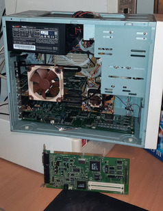

Today, I replaced my tired old oven-repaired simm-slot-replaced SB32 CT3670 for a lovely AWE32 CT3990 in my P166 setup. Fits, but only just...

So you give up bug free midi and clean sound and don't even get genuine OPL in return?

Yup 😁 well the CT3670 does not have a OPL on board either, and my particular one has a few repairs already (oven-baking included), so actually the CT3990 sounds bit better

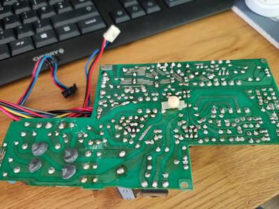

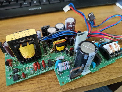

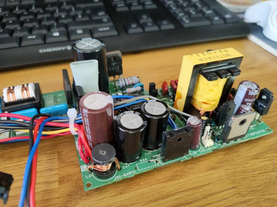

Trying to track down the source of the screeching in my recently acquired Sharp X68000 Super... I've already replaced the fan in the PSU with a quiet Noctua, which reduced the fan noise significantly (bearings were shot on the original), but the PSU squeals when in use. Which is a shame, as it works perfectly and, otherwise, the system is in tip top condition. It's just the noise that's an issue:
The attachment img_1917.jpg is no longer available
The attachment img20210324162740.jpg is no longer available
The attachment img20210324162751.jpg is no longer available
The attachment img20210324162802.jpg is no longer available
Every electrolytic has been replaced, but common wisdom says to up the capacitance of the two 5600uF filtering caps to 6800uF. So I'll try that.

Get a straw to pin point the source of noise, or a plastic or wooden chop stick and touch individual part in turn till you find the source of sound.
Back in the day when RCA and other including CTC203 chassis (this is shown printed on the back's label), was in production and in use we figured out those screech is coming from were small ferrite beads on the SMPS (power supply) diodes and transistors vibrating; easy fix was dab them with silicone RTV (clear one preferred), paying attention that glue is forced through the bead's ID hole.
But seriously, its the correct answer. I had a coworker that used a drop of epoxy and that worked just as well.
Reply 18577 of 32088, by pentiumspeed
the bead's ID mean inside diameter. BTW.
RTV saves time and softer and is best one in limited time of repair on easy types. Epoxy is wasted on these small parts, for complex parts like transformer, coils etc sure, and is needed to have a vacuum chamber and potting epoxy that resin makers uses to degas their projects if you know of one locally. Then head out there and prepare the resin pot and put the whole thing in and degas it and pull out and let it cure then scrape the pins clean or put it on stand so pins is not wetted by resin. Best way since you cannot get to all the cavities without the vacuum pot method.
I know this as I had some loose transformers needs this but takes long time to get this right.
Also, I had to prepare the removed deflection yokes that were noisy by carefully cutting few holes inside for varnish dip. Heat the yoke coil then dip. Takes 2 days to do, three dips.
