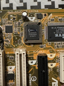

Before throwing the board away, check the bios. You need a EEPROM programmer, like a TL866II-Plus.

But I found a picture of this board, and there was a sticker on the Bios. Yours does not have it, so that is suspcious. And clearly one symptom of a missing bios is, that the board appears to be completely dead, therefore the suggestion.
I think this is the bios chip....
Reply 27 of 32, by CoffeeOne
johnvosh wrote on 2024-04-28, 18:47:
CoffeeOne wrote on 2024-04-28, 18:40:
johnvosh wrote on 2024-04-28, 18:20:
Unfortunately I don't have any programmers and I don't really want to spend CAD $100 on something that I may only use a couple times. Thank you for the suggestion though!
I understand.
Yes.
