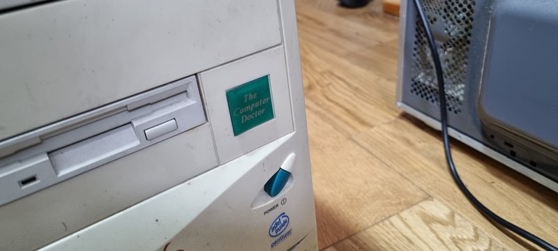

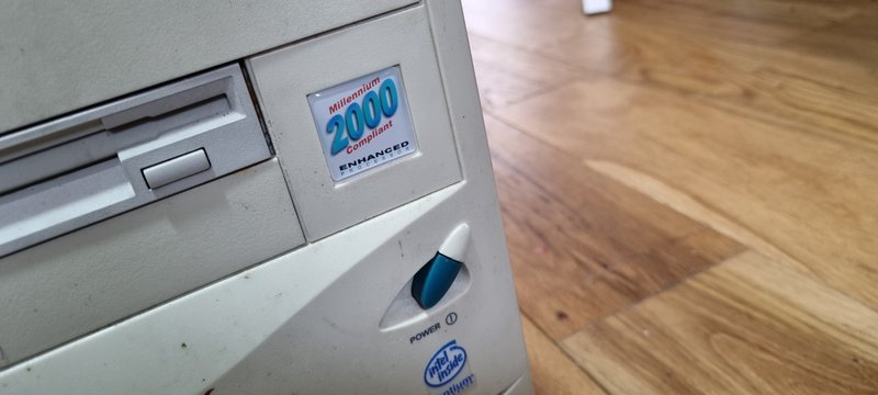

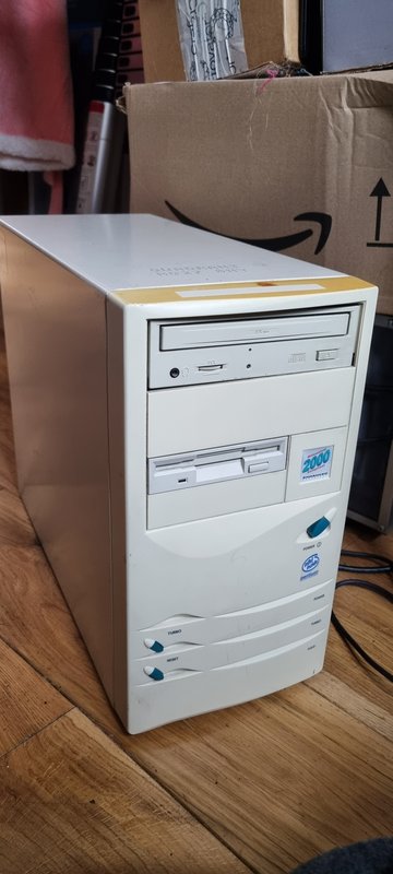

The machine arrived, its pretty worn, certainly seen better days but overall for my purposes i'm very happy.

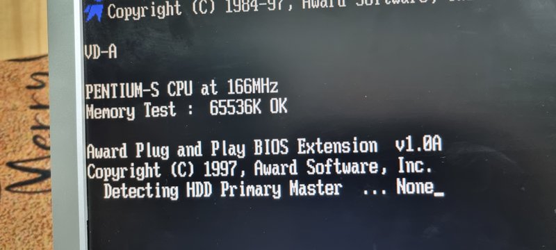

So, first surprise was it's actually a Pentium 166Mhz so a little higher clock than expected.
Thankfully though due to the info here I can slow it down so thats no issue if/when needed. Turns out there was a Turbo button but no header to connect it to like you guys said so... that sucks.
The original system builder's label was coming off but i replaced it with something i felt was appropriate...
Fitted my Sound Blaster AWE64

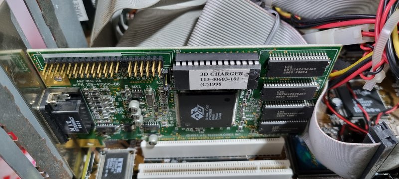

Noticed this machine actually has a ATI 3D Rage II + DVD card in it! I wasn't expecting a 3D accelerator. I presume this card will be fine with DOS? and give me a little head room for 3D if i ever needed it?
The mainboard is really nice, it's a Soyo SY-5VD. I noticed it has SD RAM slots and EDO RAM slots. Is there any point in putting SD RAM in over EDO? I know SD RAM is faster but is there any point in my use case?

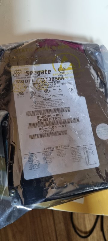

Also put the CF card reader in there, the hard disk did load up Windows 98 flawlessly and actually sounds extremely healthy for it's age but i do love the ease of transfer with a CF card.
I've got MS DOS ready to go on it but sadly lost my 8GB CF card so i've ordered a 4GB card and im waiting on that now. I forgot about MS-DOS max partition size of 2000mb so 4GB is plenty (2 partitions)
I also gave it a seriously good clean as this has clearly been used in a working enviroment most or all of it's life and it was filthy. I'm glad to say it's now cleaned up (as best as i can at least) and ready to go. The case is nice too it's a small form factor which is a plus.

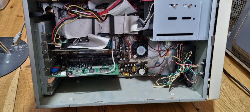

Sadly though, the machine has decided to die. It was fine but i had to remove the floppy disk as it didnt work and i had a spare outside. I did the swap over which part of that involved removing the motherboard tray out of the case.
Did all of that started it up and its completely dead. No POST, no beep codes, nothing. What is with this!? I'm so disappointed i am trying so hard to get into this hobby but the hardware just seems to die on me if i even so much as fart in the wrong direction.
I've left it off unplugged with the CMOS cleared but i doubt that will do anything. This old hardware is just crap or i have a vendetta against me. I've never had anything like it in the 1000's of PC's i've built over the years.
Athlon XP 2400+ @2Ghz|512MB DDR RAM|QDI 7X/400|PNY Geforce 4 Ti 4200 128MB w/ AGP 8x|Sound Blaster Live
Reply 36 of 46, by ux-3
Crinale0 wrote on 2024-08-19, 18:45:
Does the AT PSU spin it's own fan?
Why did you have to remove the mainboard?
Retro PC warning: The things you own end up owning you.
Reply 37 of 46, by Crinale0
ux-3 wrote on 2024-08-19, 18:59:
I had to remove it to get to the other side of the floppy disk tray, I just stripped down the entire machine and rebuilt it clearing out any dust or grime i could find. I also reseated the CPU as that sounded a little crunchy for lack of a better word. Tried to start it up with no RAM to try and force a beep code and i got one!

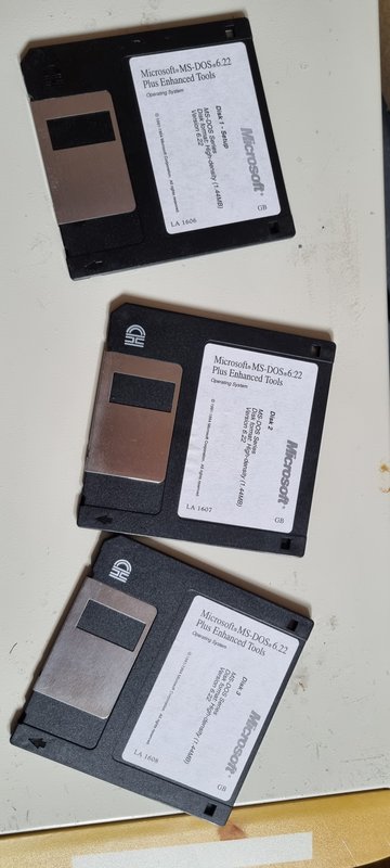

I'm pleased to say after carefully putting it all back together it is now working again, i just tried to install DOS but my second floppy disk is not reading correctly so it's onward with CD's from here onward.
