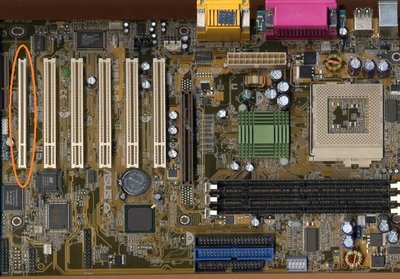

Reply 26 of 46, by melbar
See already on ebay this board!
Seems like the 6th pci slot looks really strange...
But it seems this is alright, it looks also smaller in the manual.
