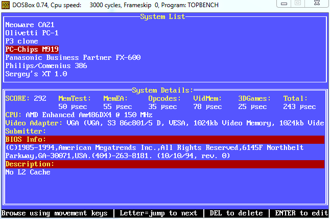

Reply 27 of 32, by TheLazy1
Something must really be wrong then 😳.
Here's mine:
Reply 28 of 32, by leileilol
Yeah, now you're making my M919 look very strange even if it does have the same am5x86 (also incorrectly reported as AMD Enhanced 486), lack of L2 cache and an s3 card. 25 3dgames score!?!
This is another thanks to Trixter here for helping me realize how crap my M919 is to other M919s 😀
So what's a good start toward this quality result? Achieve 150MHz instead of 120/160?
Reply 29 of 32, by TheLazy1
Hmm, I don't know about that.
I lost some points going back to stock from 50MHz, but not that many.
Maybe one of us is getting incorrect results?
Reply 30 of 32, by leileilol
Dunno. Got to 150mhz, put the S3 back in, seeing 131 topscore, 3dgames is 89.
EDIT: Strange. Did "Load Optimal Defaults" and i'm now up to 230 topscore and 3dgames is 35. I wonder what was slowing me down 😖
