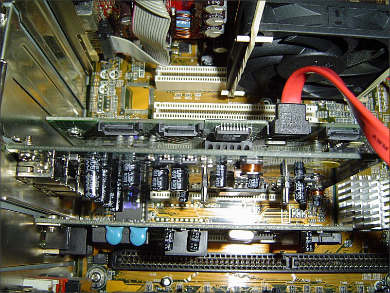

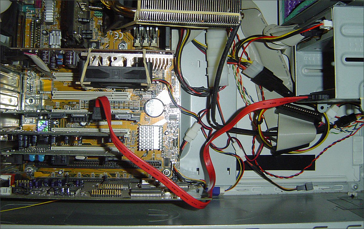

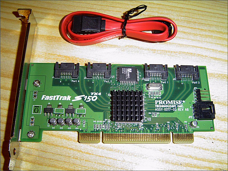

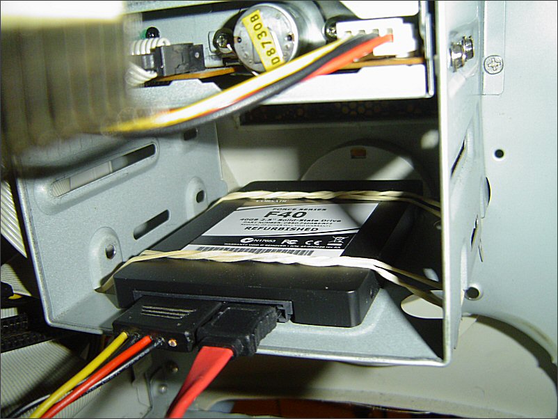

OK, got a Promise FastTrak S150 TX4 for a very reasonable EUR6.
Then I went to the shop, asked for the cheapest SSD they offered 😁 , and got a refurbished Corsair F40 for EUR35.
I had to mod (once more) the venerable Allied PSU, so ancient she didn't had a single SATA power connector 🤣 .
Keeping up with tradition, the first attempt ended in BSOD. IRQ conflict with the Promise controller attempting to use IRQ 5, and the SB AWE64 Gold claiming it as hers exclusively, and breaking the party.
After some harsh language and IRQ redistribution everyone behaved, Windows booted OK, and the Promise recognised the SSD. Then I cloned the system from the CF IDE card to the SSD, aligned the partition with Paragon, set all the Windows tricks healthy for SSDs, and set boot from SCSI in BIOS.

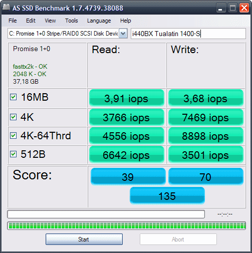

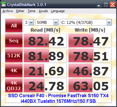

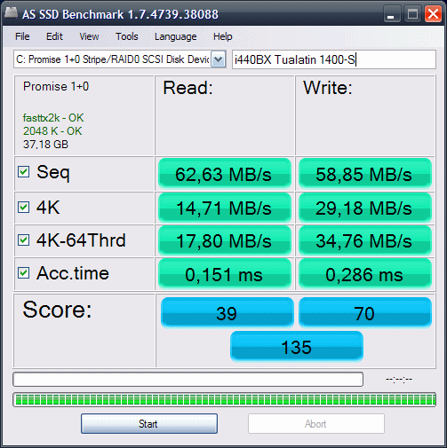

And the old dinosaur flies hypersonically now 😀 :

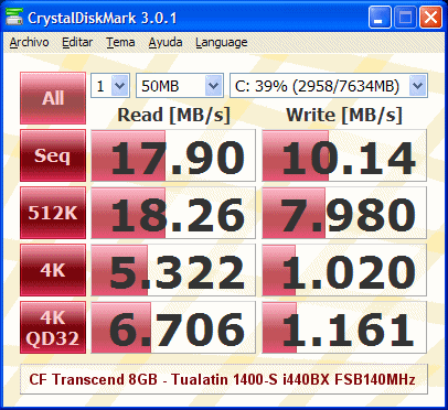

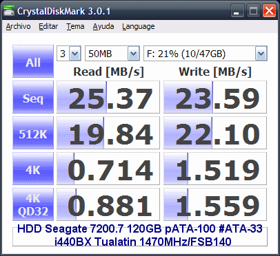

To put things in context, so ran the drives when connected directly to the i440BX ancient DMA-2/ATA-33 IDE headers. Left to right HDD Seagate 7200.7 pATA-100, CF IDE Card x400:
And so runs a Ramdisk:
A worthy investment to spice up any old machine.
