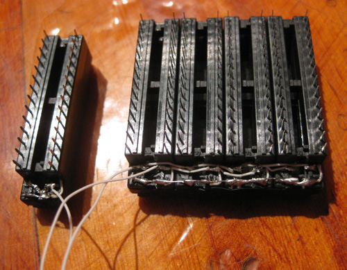

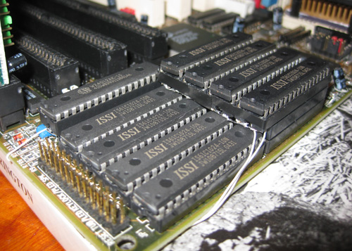

I haven't yet created an article on how to add 1024K to this motherboard because it is not yet perfected. While it works, I had to reduce the cache timing to 3-1-1-1 for good stability. I want to add some buffers, which will take around 140 solder connections, to hopefully help with this limitation. Unfortunately, all my gear is well packed away now and I do not anticipate having time to work on this for a long time. I've attached some images of my past progress though. It passes Speedsys, Memtest and all benchmarks with 3-1-1-1 and a 33 MHz FSB. All tests indicate that 1024K is indeed working, but 3-1-1-1 is not good enough for me.
