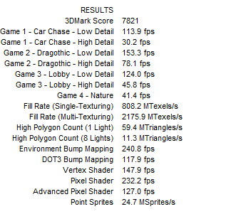

can you test 3dmark 2001SE?
Bay Trail IGP is a little slow compared to what Intel currently have for the bigger chips, even the HD Graphics (HD 2500) from the ivy bridge Celerons is much faster, but I think it's clearly better than the old GMA 4500.

Here is 3DMark01SE
Reply 30 of 31, by SPBHM
unfortunately the results I had were using XP for 2001se, I know 2006 is faster on XP compared to Vista+, but that's basically the same performance as a Radeon 8500LE with some Athlon XP 2000+ for the game test, fill rate, but much higher (for Bay trail) on pixel/vertex shader and bump mapping test.
but interesting stuff, thanks for testing.
Reply 31 of 31, by swaaye
It does seem like a Radeon 8500 or 9600 in say DirectX 7 level games like Unreal 2. On the other hand if you run something with more complex D3D 8/9 effects, it pulls ahead of those quite a bit, which is what the shader results are showing. Deux Ex Invisible War runs well, and that was a very demanding game on 8500 and 9600. It runs Defense Grid and Legend of Grimrock well too even at native 1280x800. I think this is amazing for a passively cooled device.
