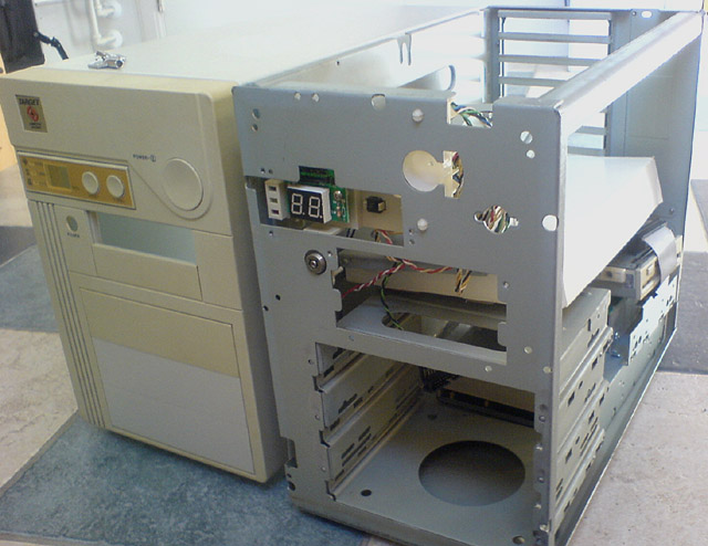

This is my case, after removing all the dust. Nice and small. Is it still the same?

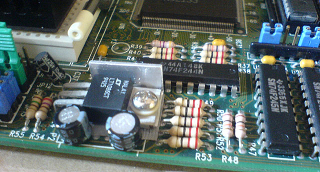

I attached a small heatsink to the VRM today. That thing gets hot, even when running a DX4 at 2x. Maybe I will make a bigger heatsink later.

Yes it was my latest recent acquisition. I bought it this saturday.. Mine case looks almost as new as it seems, yours is more yellowed.. And yes i can confirm its the same case.. Only mine turbo display is mounted on the outside of the metal case.. Mine case also have the pc-speaker inside that plastic hole thing in front of the metal case.. Also the case badge it different.. Its having a badge from vedicom (i dont know if it wouldnt say something to you) But the power supply is also a target one.. (think these are junk psus..)
My case only have a problem suddently, the metal bracket for screwing the cards in its original.. Because the expension cards dont sitting aligned in the slots..
Iam already thought about how to fix this.. Iam trying to modify the bracket a little bit so i can align it with the motherboard and case..

Don't discriminate my case because it is more yellow then yours 😉. It had been standing near a window. Yours is like new indeed, good find.
The cases are technically exactly the same, just that mine is disassembled for cleaning. I put the turbo LED there for the photo, but it was placed behind the metal front in error. No problems with misaligned expansion slots here. Fortunately the expansion-slot-grid is a separate piece bolted to the back-plate.
Junk PSU?, if you say so. I am still using it actually. But the fan has been replaced. The original fan made a lot of noise, it was terrible.
