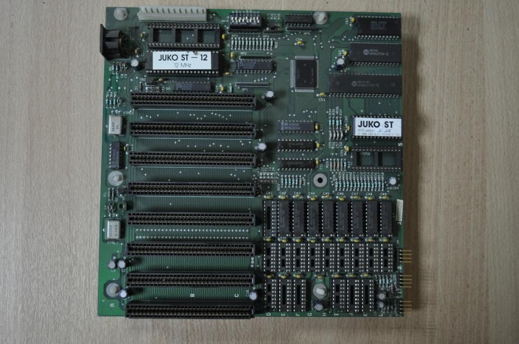

Since i came to live in the UK the retro bug never stop biting. I actually miss the stuff. I'l pllaning a super socket 7 build f […]
Since i came to live in the UK the retro bug never stop biting. I actually miss the stuff. I'l pllaning a super socket 7 build for which i already got a motherboard for. This will be my main time machine here in England.
In the mean time i always wished for something pre 386. I do have a 286 motherboard, but i always wanted to build a turbo XT system. Actually i would prefer a Tandy 1000, but ordering one from the US will cost an arm and a leg not to mention customs headaches. I will love getting around the technical difficulties of the XT 8bit bus. I'm still gathering parts to assemble this build and i'm gonna assemble it when i return to Portugal on vacation.
This is the board i got:
board_xt_zps375cc201.jpg?t=1412354932

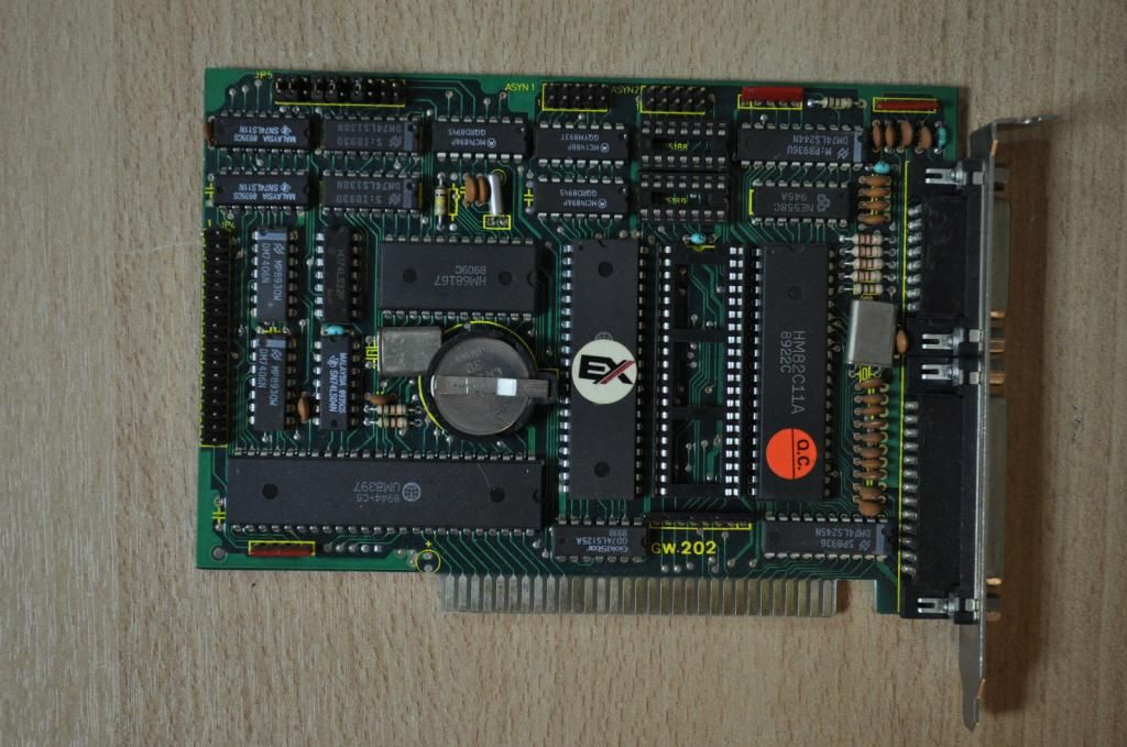

I also got a Multi I/O card including Parallel, Serial, Gameport and Floppy controllers and a CR2032 holder for a RTC:
MultiIO_RTC_Floppy_zpsf012637b.jpg?t=1412354943
