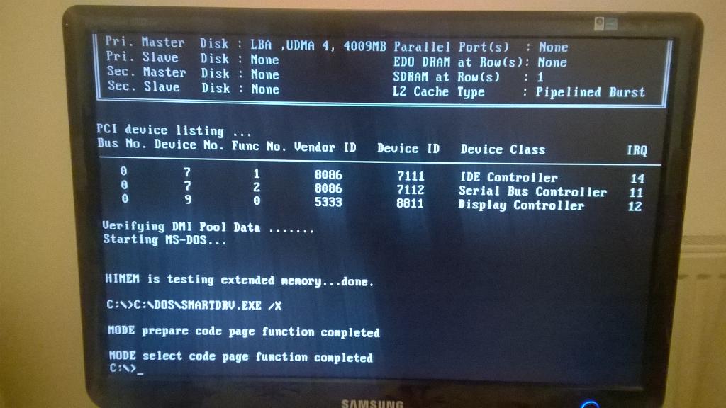

Booted fine:
The 4GB Transcend branded CF card was a pain. My motherboard seemed to be unable to find MBR and boot, but some tinkering and patience finally paid off:

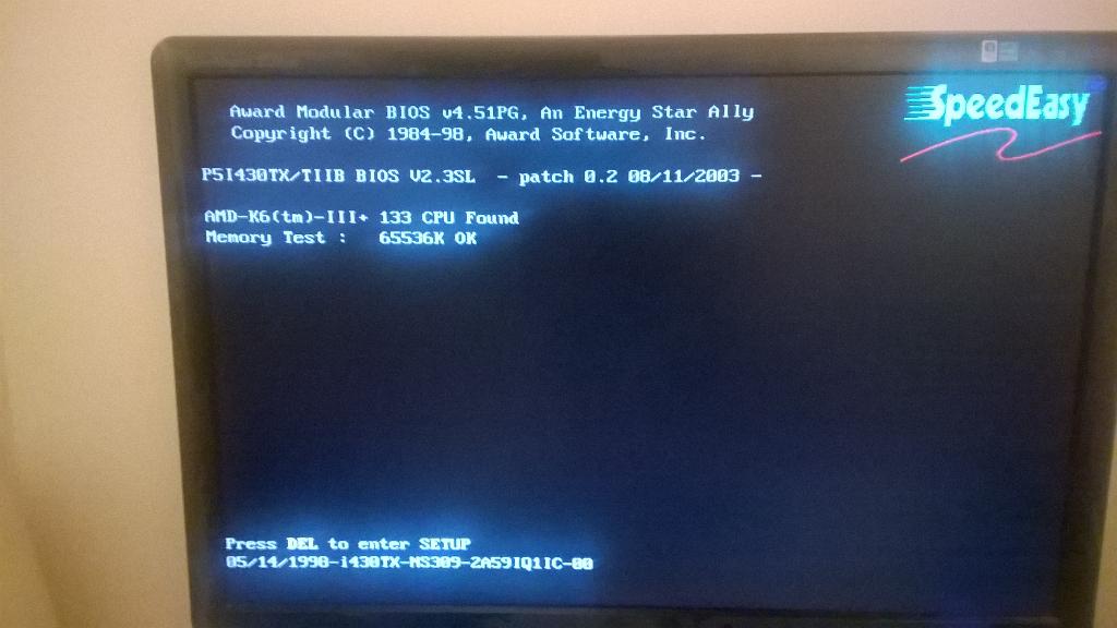

Then the scary part flashing the board with improved BIOS. Usually i'm not scared of flashing BIOS'es but this one has a surface mounted PLCC type EEPROM. But all went well and i could now install a K6+ CPU:
B4mHz22IIAA2Ze5.jpg:large

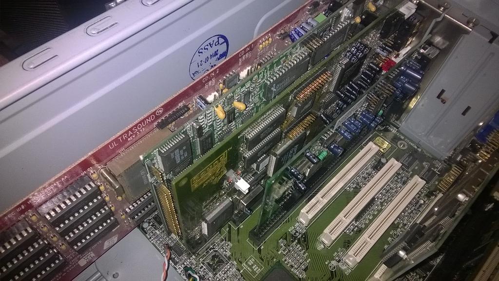

Then my favourite bit, installing the sound cards, Gravis Ultrasound Classic, Pro Audio Spectrum Plus, AWE64 Gold and the Yamaha YMF704C/719 card.
B4mM9toIgAASCEn.jpg:large
The Yamaha card was way to noisy until after a lot of head scratching i found out that the crappy Ymersion 3D stuff was on. So i disabled that crap and now the card actually sounds pretty good. Really good.
Now the PAS card is weird. I can't get it to work well alongside the other cards. Sometimes i can get PCM to work, other times i can only get FM. Most of the times FM is silent. It's weird because only the native PAS part is active, but i guess that the card still fights for other resources. I might try to remove all other cards from the system. Thinking about it i used the PAS16 drivers from VogonsDrivers, i wonder if there are more suitable drivers for the Pro Audio Spectrum Plus? I couldn't find anything specific for this particular card...
Anyway all other cards work just great all together. The SB16 part on the AWE64 is actually disabled, only the EMU8000 synth is to use anyway. The PAS Plus card was supposed to be a temporary thing anyway. What i really want there is the original 8bit dual OPL2 Pro Audio Spectrum. I have a feeling this card will be less of a hassle really. Plus its alot more usable. I love some dual OPL2 renditions on some games.
