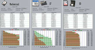

These days I'm experimenting with SD as I've heard a lot of good from them, fixing lba chs translation, good dma support, speed on par with CF, etc. So my expectation where high. I wanted to replace a cheap 32gb CF I use to run win98. But I was very disappointed with SD, not only was it hard to make it boot, but then it was utterly slow. So I decided I would buy an fast sandisk extreme pro udma 7 32gb CF instead and do some more benchmarking with that card (thank you SpeedPAK, it wont take ages before it arrive)
What I found surprising is that, even the CF is equivalent or faster than a mechanical IDE, it actually feel way slower as win98 dont want to use DMA on it. The card say it support it on BIOS and tools such as NSSI. But win98 uncheck it on device manager every time. So the card seem like you are running in PIO and every disk access feel like a burden for the whole computer. It's not that bad and I prefer having a silent vintage computer than a fast one, but still I'm curious as to know why. Do you have an idea about that ? The cheap blue and white CF is the one pictured on my benchmark graphic.
Also the SD results are so bad (notice the lower graphic scale value is 10 time slower than the two other) it make me feel I did something wrong, I formatted it with partition magic 5 in a secondary ide as it seem harder to make it work than a CF when prepared from another computer. I intend to do so more experimentation tonight with stuff like minitool partition wizard.
