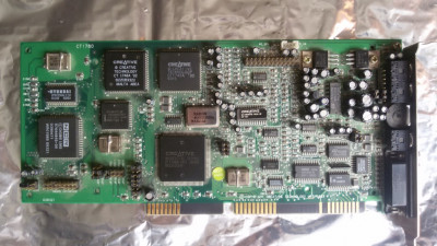

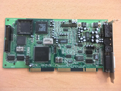

Reply 29 of 184, by bristlehog
There are CT1780 and CT1790 versions of SB16, with Philips and Sony CD interfaces. Here's more detailed info: https://ilovepa.ws/2017/06/13/the-legendary-sound-blaster/
CT1780 is (or was) owned by Artex, Kahenraz, easyjohn. I know where to get one for ~$100 if need be.
Fagear has a CT1790 in his collection: http://hw.fagear.ru/creative-sound-blaster-16-asp-ct1790/ (his website is in Russian)
The CT1730 is a subvariant of CT1740 with small differences. Fagear has it too: http://hw.fagear.ru/creative-sound-blaster-16-ct1730/
Also he's got some other variants:
    221.43 KiB
    3405 views
    CT1780
    431.87 KiB
    3423 views
    CT1790

Reply 32 of 184, by Burrito78
bristlehog wrote on 2020-01-12, 14:00:
There are CT1780 and CT1790 versions of SB16, with Philips and Sony CD interfaces. Here's more detailed info: https://ilovepa.ws […]
SB16:
CT2830: http://hw.fagear.ru/creative-sound-blaster-16-ide-ct2830/
CT2920: http://hw.fagear.ru/creative-sound-blaster-16-ct2920/
CT4100: http://hw.fagear.ru/creative-sound-blaster-vibra-16-ct4100/
AWE32:
CT4330: http://hw.fagear.ru/creative-sound-blaster-aw … 2-value-ct4330/
Thanks for the links and especially the pictures! I will add the cards asap!
