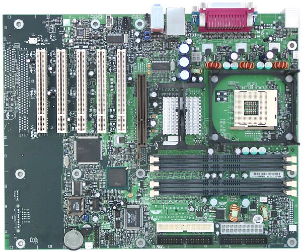

If you'll find Intel D850MV board it will be best choice.
Socket-478 and Northwood CPUs, USB2.0 if NEC controller is installed, PC/PCI, RDRAM 800/1066 up to 2GB, FSB533 !!!
And exclusive points about Northwood:
- it already has 0x19A register - frequency divisor - and the best throttle quality for old DOS unlike Tualatin and Willamette
- it has Hyper-Threading which is very useful in Windows XP
Oh, why did you think that WinXP shouldn't work well on i850 board? Of course you need not Win2000, make dual boot 98/XP and enjoy! Often Windows 98 won't work with RAM more than 512MB and needs BURNMEM.SYS driver. But on i850 motherboard Win98 works well always with 1GB RAM and sometimes even with 2GB !!! I've checked.

I'm looking for s775+PCIE+5xPCI boards too but still can't find them. Because I look for ICH7 boards. GA-P43T is ICH10 board and may have problems with Windows 98 and throttling under DOS. If you have this board ask ruthan about it. He is experimenting with ICH10 boards.
I want to find this one:
It's ICH7 board and it hasn't problems with DOS and Win98. It supports only two cores CPUs but in Windows XP you will not feel more performance if use four cores CPU.
